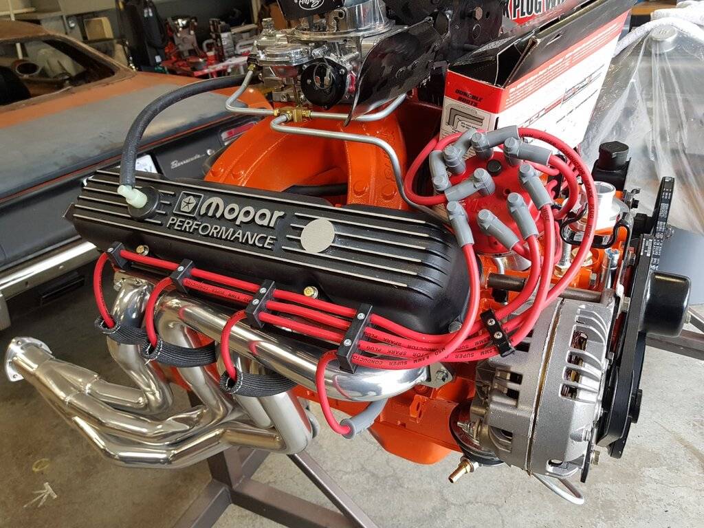

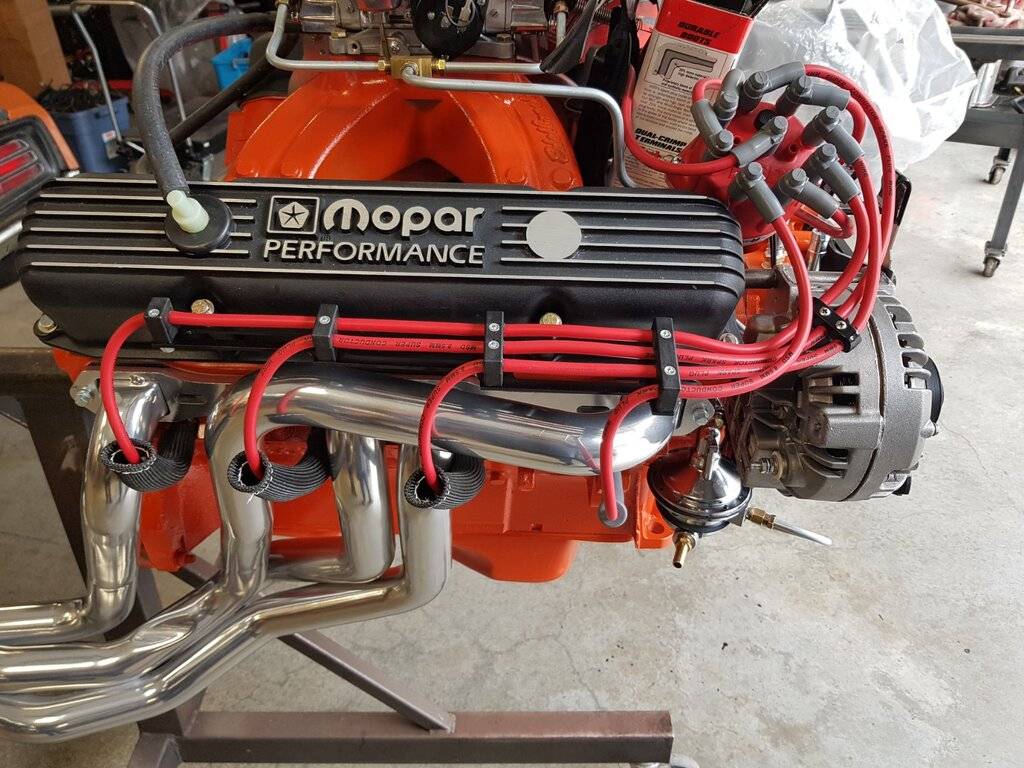

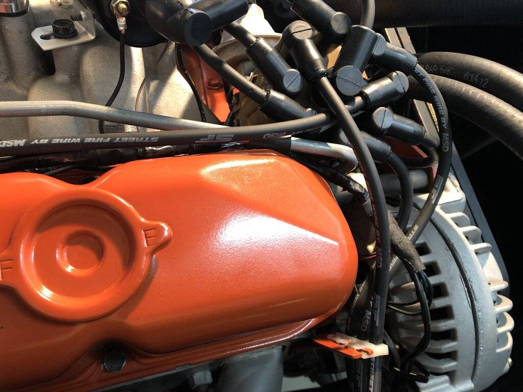

I got generic wore loom holders I put under the valve cover bolt. Nothing fancy, but keeps the wires from hitting the headers. I'll grab some pictures when I get home.

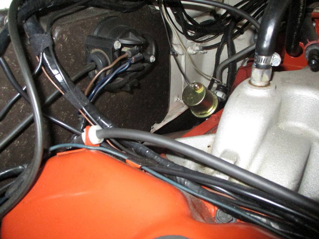

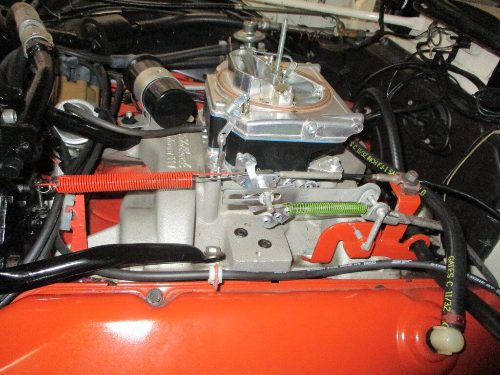

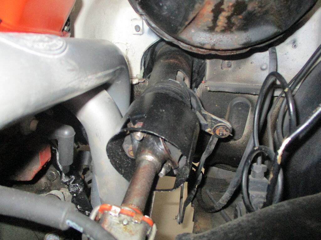

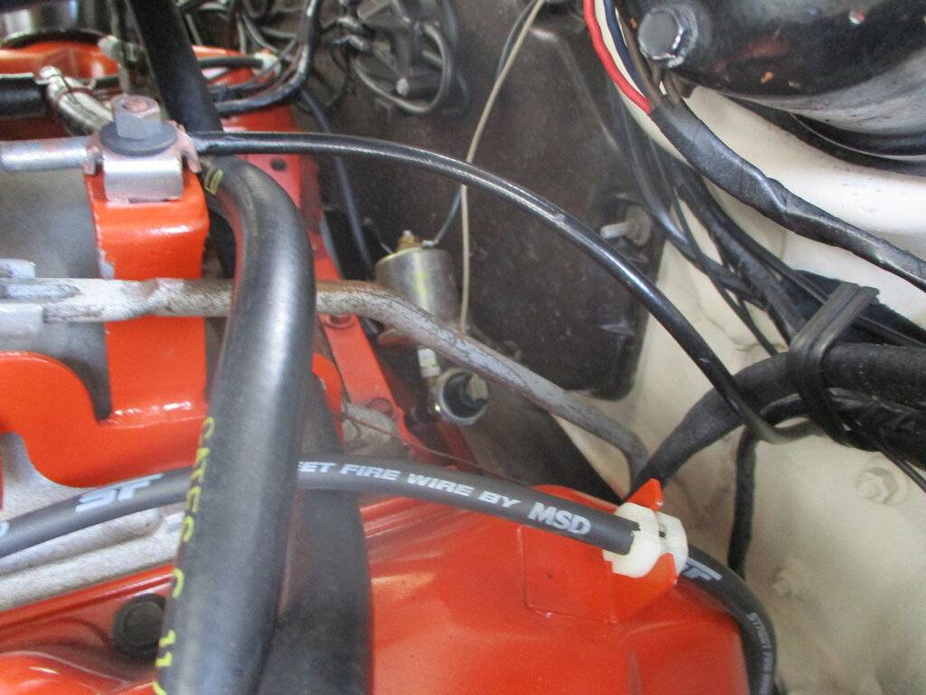

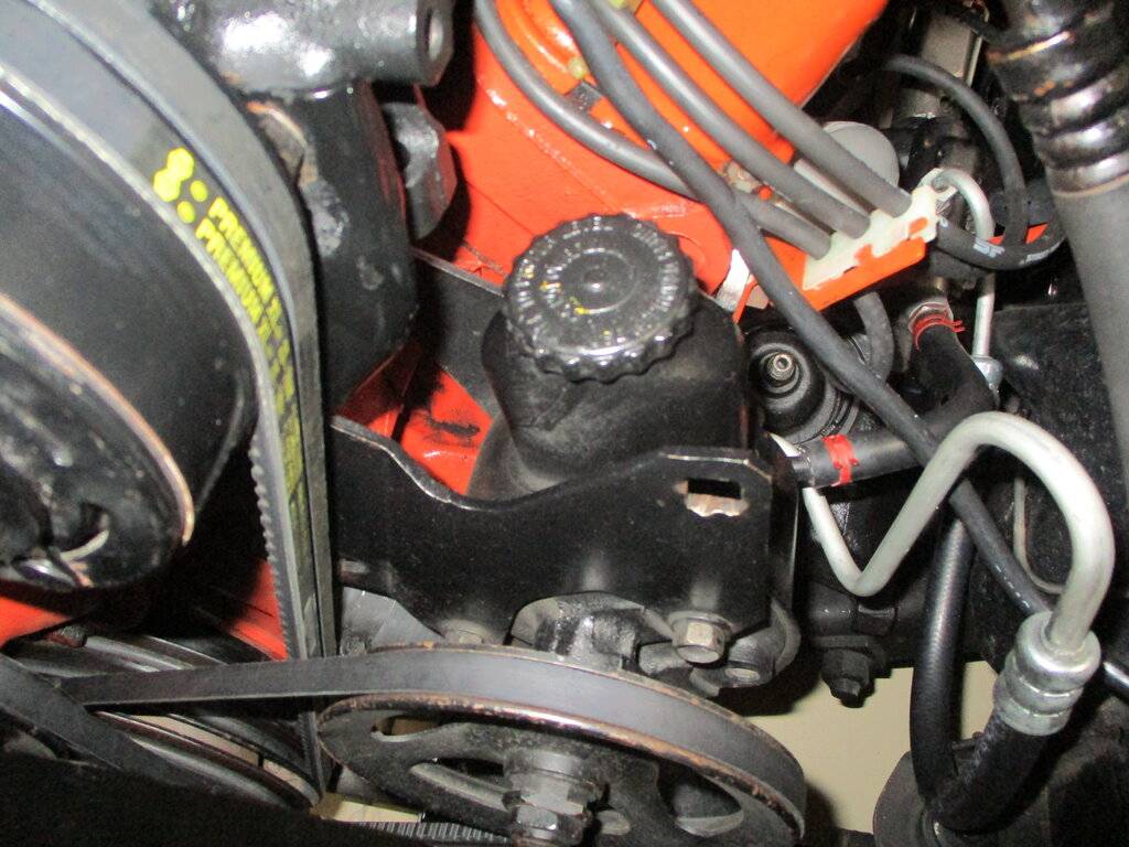

I used Hoffman's repro looms, modified them a bit as needed (bet you can't tell where!) and used two sets of MSD StreetFire cables so that I'd have whatever mix of straight or angled plug boots I needed at each plug. The cables are custom length fit, btw, so you can run them "a bit wide" to gain clearance near header pipes. No. 7 and 8 run along the valve covers and into Hoffman rear head loom and down to the plugs as per OEM.
And here's the tricky No. 7 hole.

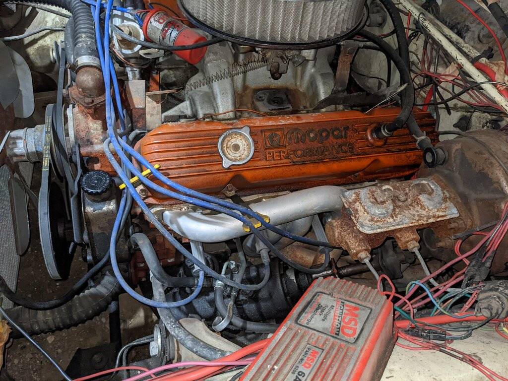

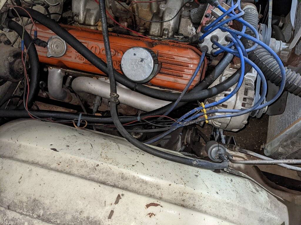

While no where near as clean as @Trace 300 Hurst, here's my looms. The engine bay is a mess, it was this way from the day I owned it, so it's original, right? :D

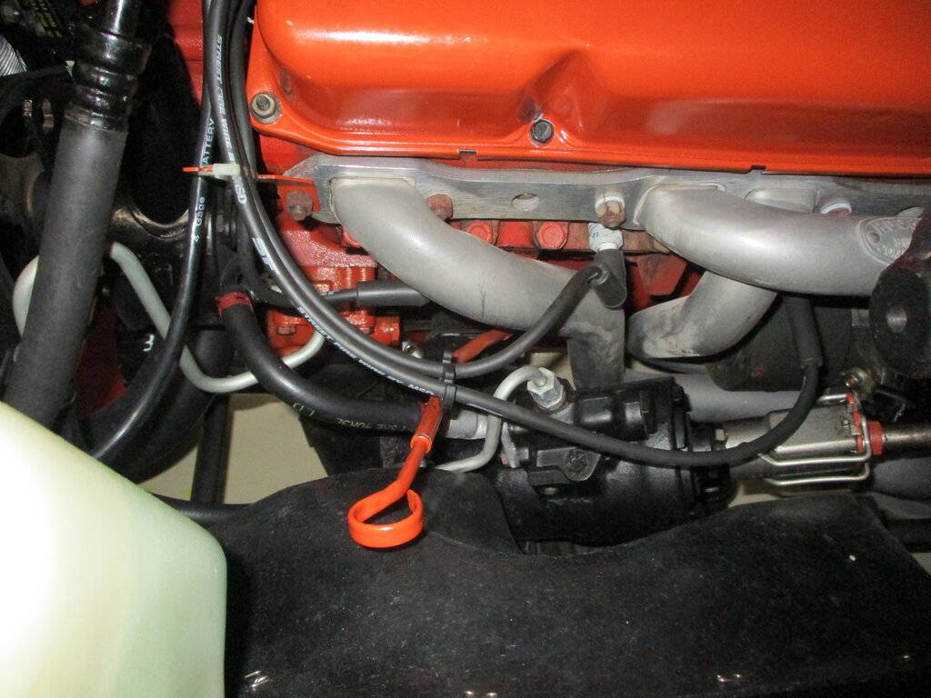

The Hookers are a bit more forgiving when it comes to wires than the tti's are.
The Challenger has a set of Taylor wires on it now with 90 degree boots that are super close to the header tubes. The boots must be silicone, as they didn't melt when I drove the car back to his house.
You're not kiddin'
I'd advise bringing along a fire extinguisher any time you take this one for a drive.
The splice in the fuel line right over the header gets the safety prize. :eek:
The plug wire routing actually isn't all that bad. There's a lot more room in a C body than in the Challenger. The right header is only an inch or so from the inner fender on the Challenger.
