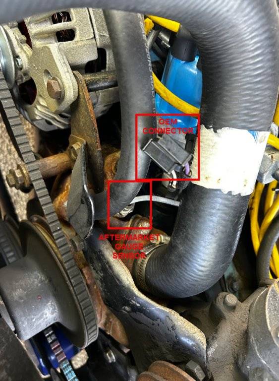

My '71 300 had an aftermarket gauge kit put in using the original temperature sensor hole. The wires for the original sensor were left unconnected.
I would like to bring them back to functionality, because I want the gauge and the lights!
Does anyone know the part number for the correct sensor to use? It runs the 'cold' and 'hot' warning lights.

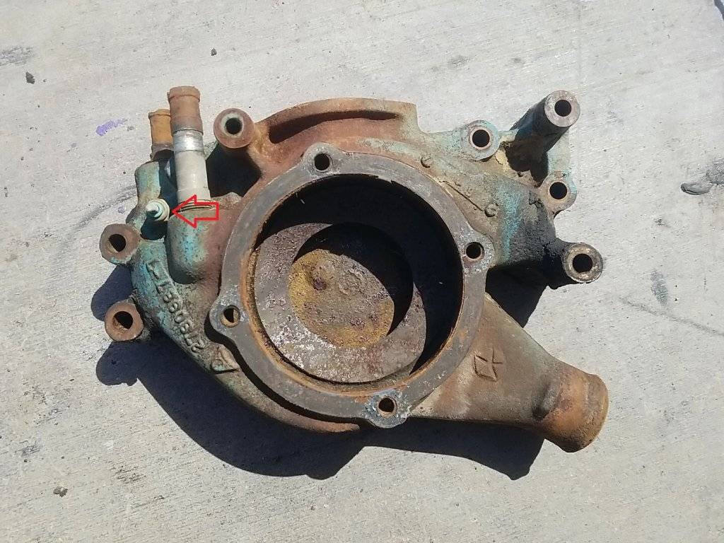

Here's a pic showing the other port. This is used in cars with temperature gauges and should be in yours too with a pipe plug in it.

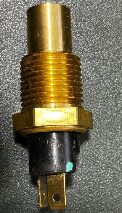

Rock Auto has a closeout on the correct switch right now:
More Information for FAMOUS BRAND WTA1137

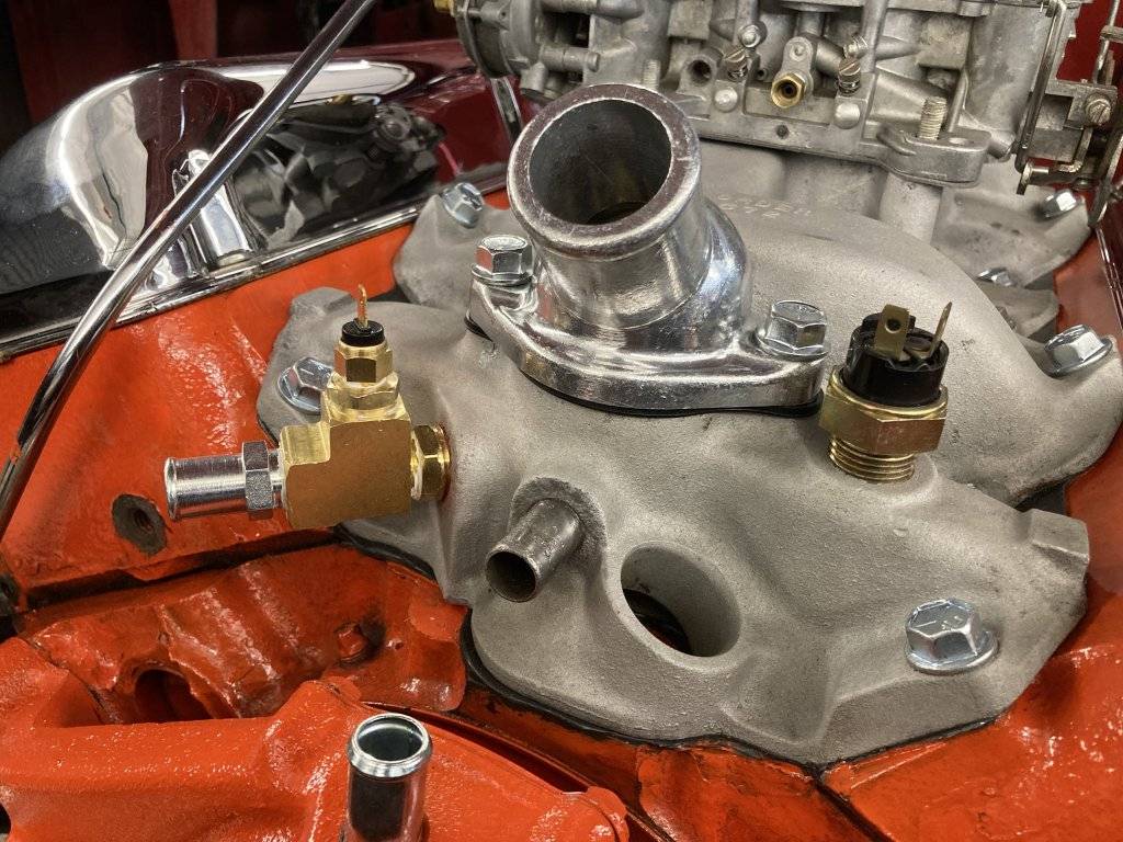

There's two ways to accomplish your goal.
1. If it's small enough, move the gauge sender to the small factory hole that Big John pointed out, or find a small diameter sender that will work with the gauge.
2. Get an in-line fitting for one of the senders that can be installed in the heater hose going to the heater core. This won't be as accurate as choice #1, since the heater hose temp will be a bit lower than actual engine temp.

Also, once Rock Auto runs out of these senders, Chrysler used the same cold/hot temp switch as GM did on many of it's early to mid sixties cars. There are plenty of NOS GM switches on ebay.
Jeff
Finding the GM "cross-over" sensors will require some homework by the buyer! Which can come from the RockAuto catalog when you click on the particular part number of the sensor. Those listings also list other brands the part might fit IF there are some.
IF you might find a good NOS GM switch, give the seller the GM part number or aftermarket brand part number. DO NOT tell them it is not for a non-GM vehicle!!! They can only verify what is in their catalogs, so if yuou ask if it might fit a Chrysler, they'll probably say "No". Just BEST to not get to that point, by observation.
