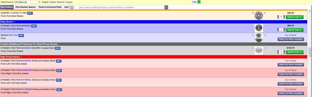

I checked it out here and found he's correct:
1969 CHRYSLER 300 7.2L 440cid V8 Rotor | RockAuto

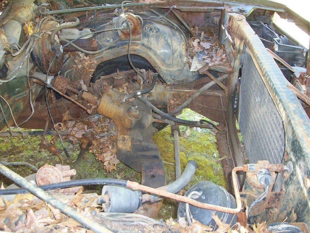

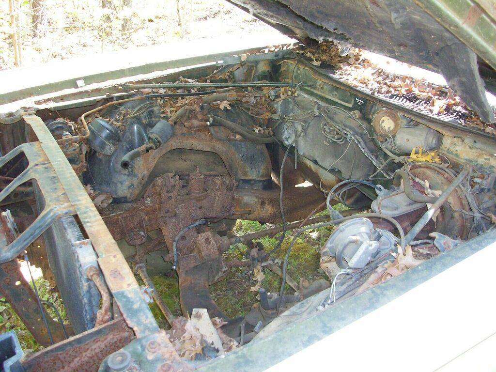

the eBay listing has a picture of it, kind of obscured by the leaves and such but it might be obvious what type it is from the picture:
That is the single diaphragm booster, it won't fit your '68, so you will need to try and find a dual diaphragm booster '68-'70 (some '71's had this booster and some '72's with either the police option or heavy tow option).
