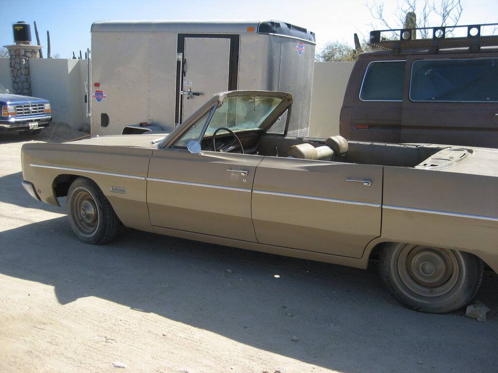

How bout a pic of how she sits now.
This is the best I can do. Haven't photo'd the car in a while as I'm in the process of a sort of restoration. Tons of photos of the engine area.

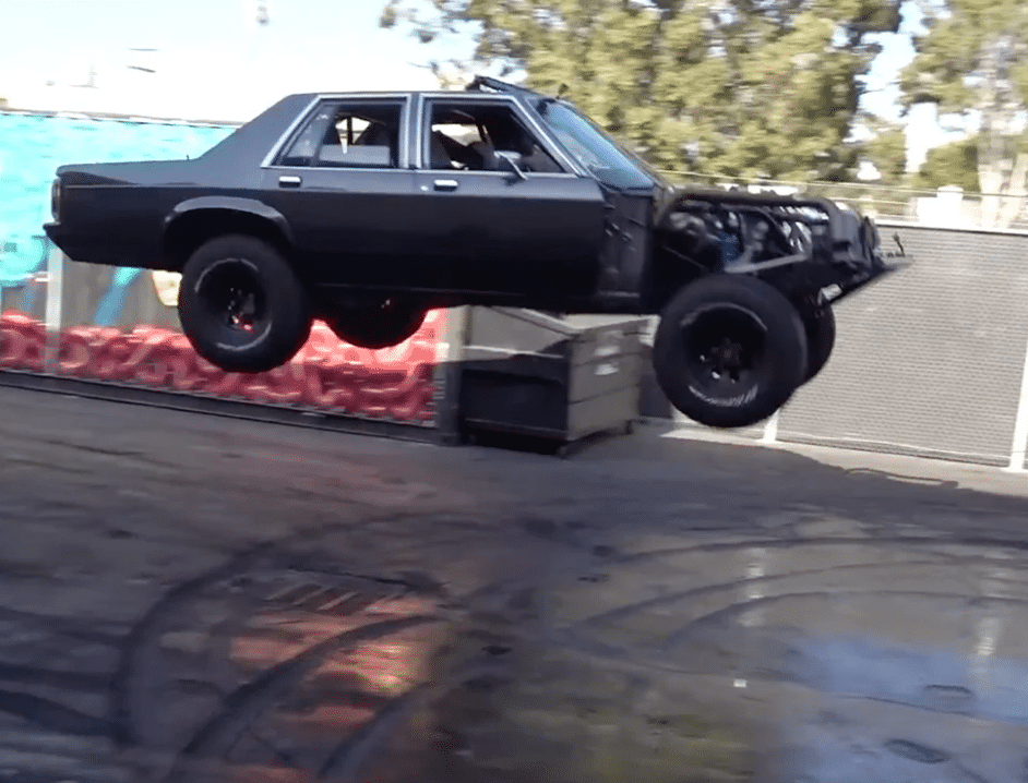

Just promise us that you won't go as far as dropping the body on a suburban chassis so you can make a pre-runner:
wow!! That is hilarious!!!
Someone has a great sense of humor and a big pocket book.
