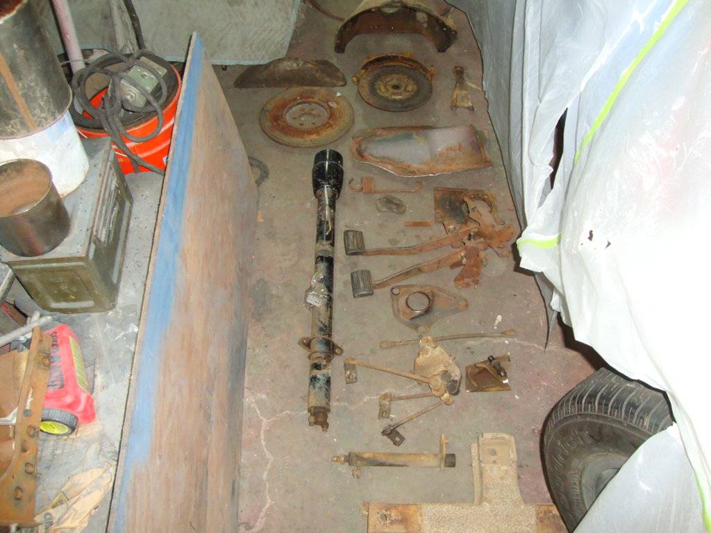

at least you gone nearly the season out of it , new subframe ha ? after market or oem disc setup ? i grabbed a 70 nyr disc front end for my 65 880 rag , and these is a motor that needs to get built as well , and swapping out the 727 four an a833 4spd . got a swapout of a 66 sport fury too do it with , column to the peddles z bar linkages hurst shifter even the bellhousing n flywheel/clutch core . just started this deal with a cam grinder buddy , building nice engines for a fair price . alot of leg work involved but if it pans out , i'll be having fresh motors in everything .
