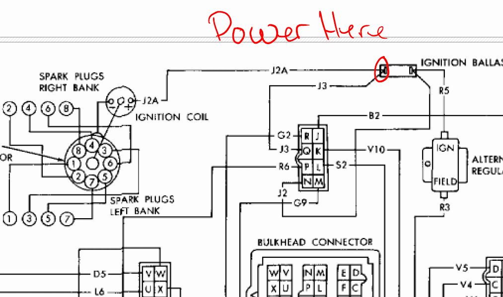

Just energize the ignition from the battery (power to the resistor), and then just short the relay to kick over the engine.
Powering this post will give full 12V to the coil which is normal during starting, but you don't want to run it too long this way else it will burn up the coil. Normally during the starting cycle the coil sees full 12v, then switches across the resistor. Now you can do that from the get go, but it may not start as easily or at all.
Short momentarily.

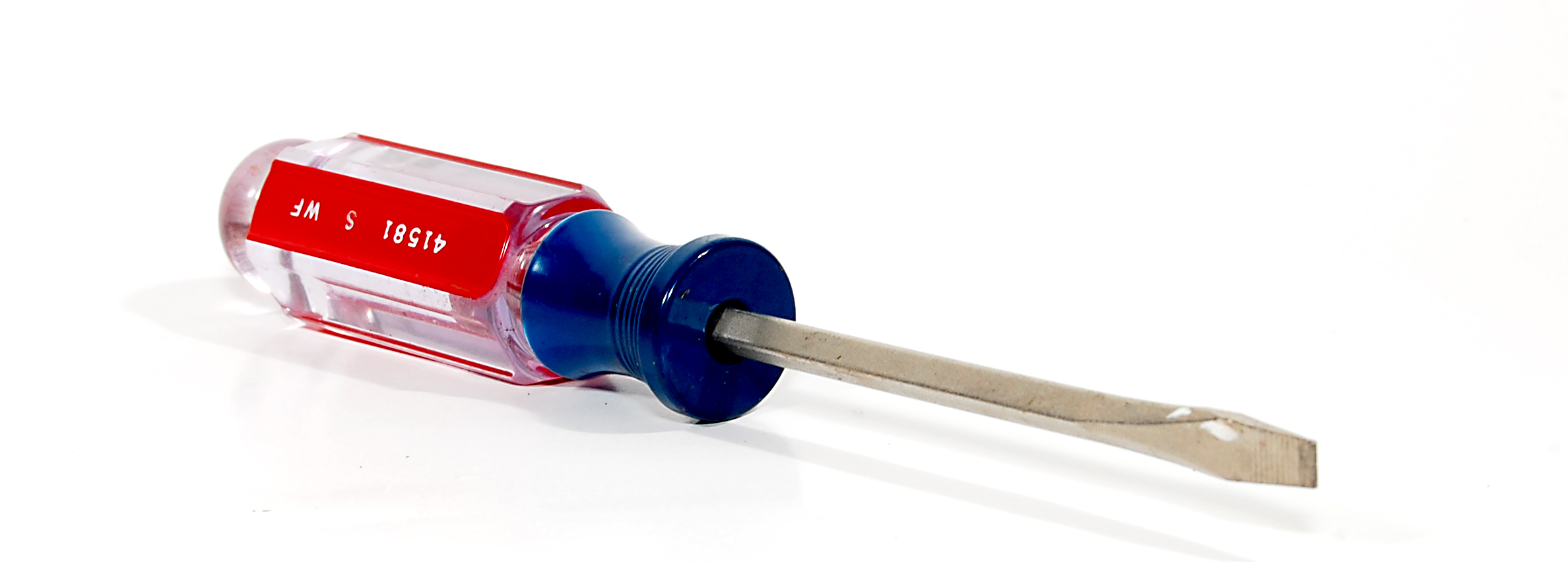

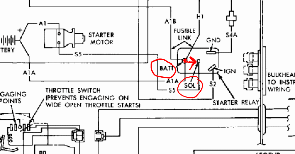

In all seriousness, just reach under and run a jumper wire from BATT to IGN and then under the hood jump the solenoid with the screwdriver to start it.
