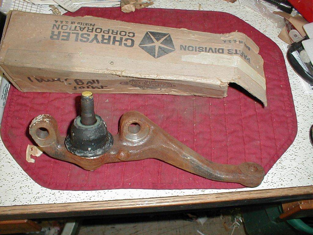

The lower is replaced as a unit, as the FSM shows. It bolts to the spindle. Unfortuinately there is no alternative. The Mevotech listing is wrong. It may be the UPPER balljoint though, because the upper looks like the one pictured in your link.
Correct lower balljoint looks like this:

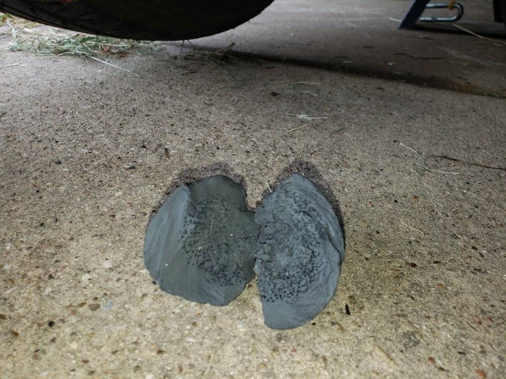

I wanted to jump in about P-S-T parts - I got the entire front end rebuild from PST for a 68 fury. the stuff has failed already. they say its dry rot and will not honor replacement. then they want me to send in the parts so they can evaluate them.
I drive my car 1x/week, and only for about an hour at a time. its my sunday funday car. it gets 0 abuse, doesn't get driven in rain, etc., etc. and the PST rubber has already failed.
just sayin.

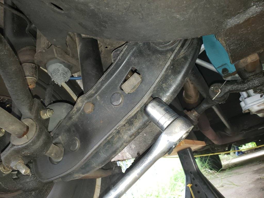

i was setting my torsion bars back and looked up into the chassis and this . ..

View attachment 325264 I wanted to jump in about P-S-T parts - I got the entire front end rebuild from PST for a 68 fury. the stuff has failed already. they say its dry rot and will not honor replacement. then they want me to send in the parts so they can evaluate them.
just sayin.
Is that a bumper and that rotted off? That was one part I didn't use from their kit.
