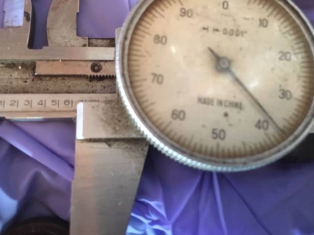

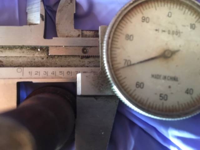

I have a 71 C body rear under my drag car FURYIOUS. I need to install the long (3 inch) wheel studs. They are sold by knurl size. So I knocked an old stud out & measured it. It’s 668 on the spline & 637 on the shoulder. I have 625 too small & 685 too big. So what size should I purchase
