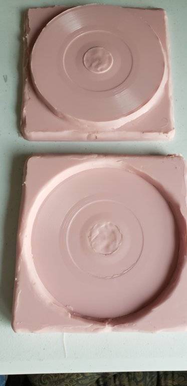

Many know I have made taillight lenses for Goldie my '66 300. A few know I started messing with jukeboxes this winter, so a natural progression in my mind is to replicate a 45.

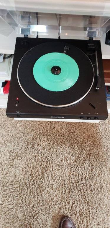

I managed to reproduce a working double sided stereo record. It plays and sounds just as good as the original.
Another project where the satisfaction from an idea coming to life outweighs the cost of doing it.

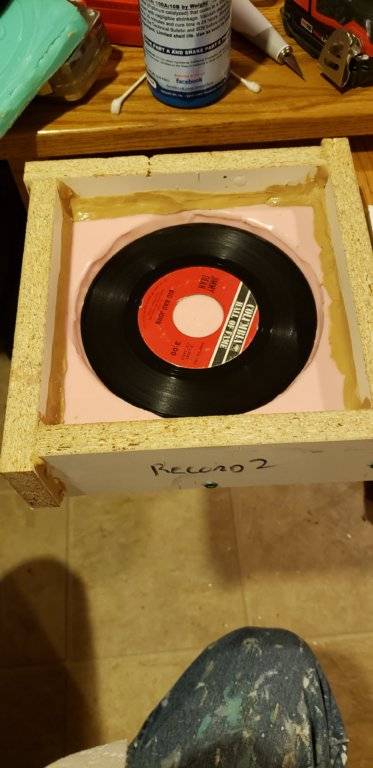

No I used one that is a polyurethane resin which is harder. I used a different stiffest mold material they make.
I going to make one out of the lens material because it is clear so I can make some really cool looking translucent records. This one was supposed to be kelly green but the white base made it mint green.

I could buy an original much cheaper on the internet. :) My biggest chunk is in the mold material. The record itself has about $3 of resin.
This product is in my pressure pot for 16 hours and a post heat cure at 150° for 4 hours, so I am not exactly pumping them out. :)

No the record needs to stay in place for the second pour of the mold. It is essential sealed in place to the first pour. I still got some minor seepage under the record but thankfully not into the playing surface.
That being said I could probably cast the top of one mold and the bottom of another and make a double a side record that way. It's not practical however when the double sided mold runs about $50 in mold material.

I am curious about any degradation of the mold too I will definitely be comparing. I picked a nice bright sounding record so if the is any change in the sound quality it should be noticeable.
The mold material is amazing and this is the densest product.
The resin I use for the record should be much more durable than vinyl.
