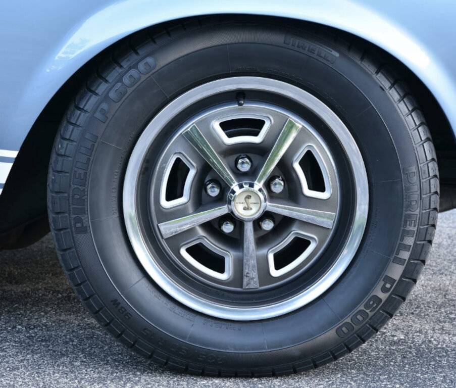

Looks really sharp as is but I know everyone wants to shake things up from time to time. You might look at these 15” wheel covers as an alternative to the new magnums. Shelby type are $$$$ but the t bird or LTD are as cheap as $15 each. Slap on a magnum decal and you’re go to go...
They are Ford 67 to 70/71 for Shelby Mustang T birds and the LTD.
