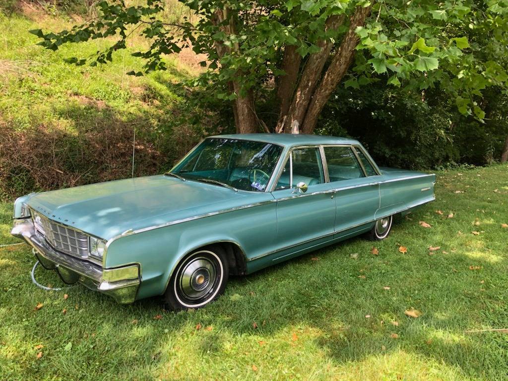

Yes! Want to see the photos. I bought my 65 NYer back in early September, and did a lot of the things you described on your 300. LOTS of chasing gremlins down. But now, the more I drive it, the better it runs. Congrats!

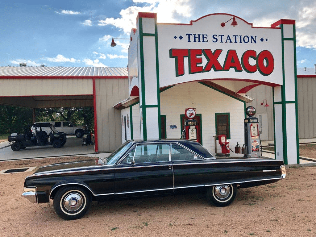

Your car is a twin to mine except I have no VT. And mine's currently black but was originally silver.
But I do have leather (underneath cheapie seatcovers).
