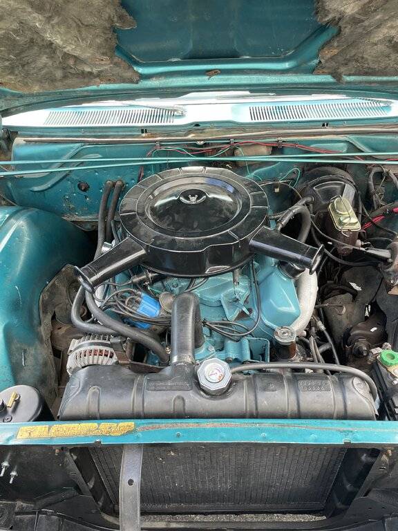

Pic

It seems to me that you have one of three things wrong... Covers bent, gasket is bad, or the master cylinder is in bad shape where the gasket seals to.
So, you can replace the cover, seal, or MC. Finding a good cover or gasket means hoping someone has an old one laying around... Or if they have a new one, bet it's not much less than the price of a new MC.
By the time you get all done, you can buy another MC and be done with it.
