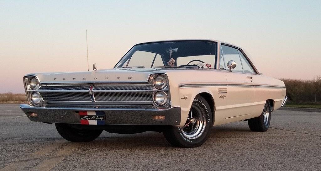

I recently went down this same path. Here is what I put on my 65 Sport Fury .
255 60/R15 on 8x15s 4.5 " BS in the rear.
215 65/R15s on 7x15s up front. I went with this size to add to the rake I was looking for. You can also go with 70s as was recommended to me as the more exact fit to the rear tire height, but again, I was looking for a style.
I felt the 275 was too much tire and I'm happy with my choice. The 255s fit great and look right in my opinion.
Yup, looks great to me also! :thumbsup:
Very nice, well done!
