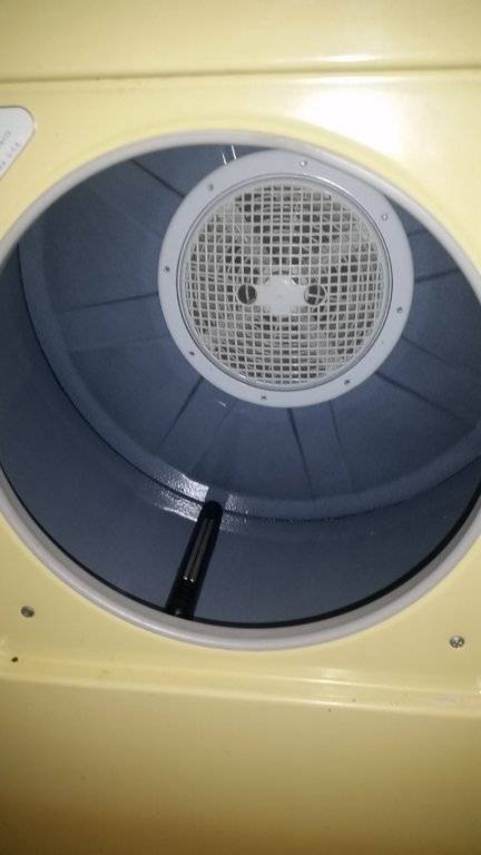

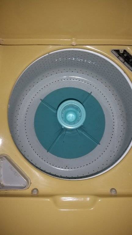

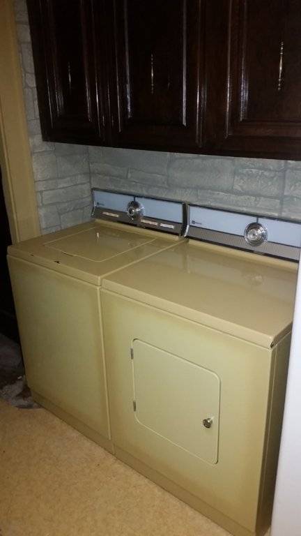

As suggested in "remember when" here is the maytag repair thread. No work done yet, so here are some pictures. These workhorses are from 1974. And have worked without service until the heating element died in the dryer. I just moved them back upstairs and don't have them hooked up yet, but the washer weighs 230 pounds with no water in it.

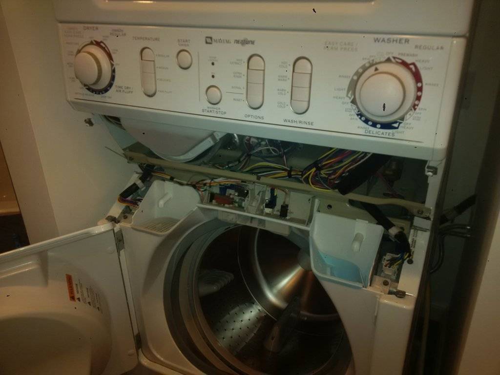

Safety and water use mandates have pretty much rendered that impossible. They all have boards, even if the interfaces are mechanical. For example, I've been chasing an intermittent spin issue on this 2003 Maytag. It has a safety logic board that not only has to see a closed door, but that the door has opened and closed since the last demand for "spin".
Until I have more time, it just sits in pieces and I occasionally jumper the door switch AFTER it has seen a "door open" cycle, but during the wash cycle.

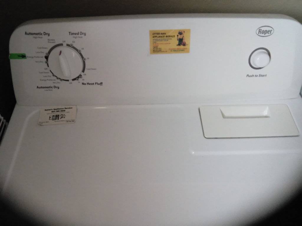

Gonna have to disagree with this. My 350 dollar Ropar is all electro-mechanical. I even checked the parts book for my model.
FWIW, this entry level Roper Model from GE is also sold under a zillion other Brand names.
And it works better than my previous "state of the art" $$$$ Fisher Paykal...
One dial and a Start button. Gotta love it.
