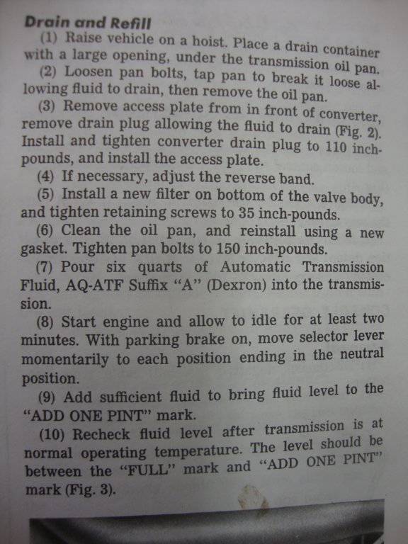

I've never heard of that technique before. Are you cereal? If so, where did you learn of it and what is the advantage? It's stamped right into the dipstick to check when hot and in neutral.
I respectfully submit my evidence...
My mentor taught me that way when I was 16.
Old timer transmission rebuilders who remember 727's have told me the same.
They beat it into me.
I have the scars.
You guys do it your way.
I have the scars.

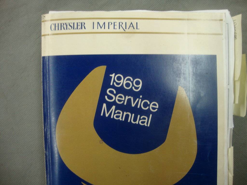

Im not saying you are wrong Stan...Im only saying that's what the FSM told me.

If you carefully check it in "D", rather than "N", then the fluid level would be lower as the various valve body passages would have pressurized oil in them, as would the various "apply" accumulator and friction item actuators. Not sure how much that might be, quantity-wise, but it could make a difference. But the level in "N" would sure be higher than with the lines charged in "D", I suspect.
