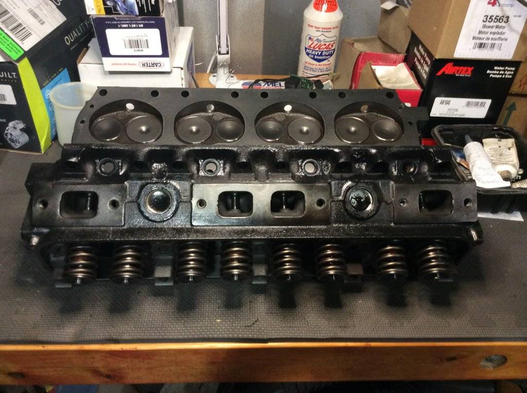

Took the New Yorker for a ride today to pick up the heads for the engine going in the Lil Red Express I got last year. They are a pair of 516 casting with new valves, springs, retainers and keepers. Had bronze liners installed in the guides, hardened seats for the larger 1.74 exhaust valves, positive seals and a couple other things that needed to be done.
NICE!!! You’re going to love those!:thumbsup:
