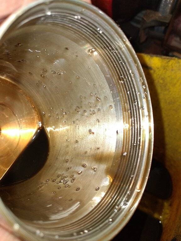

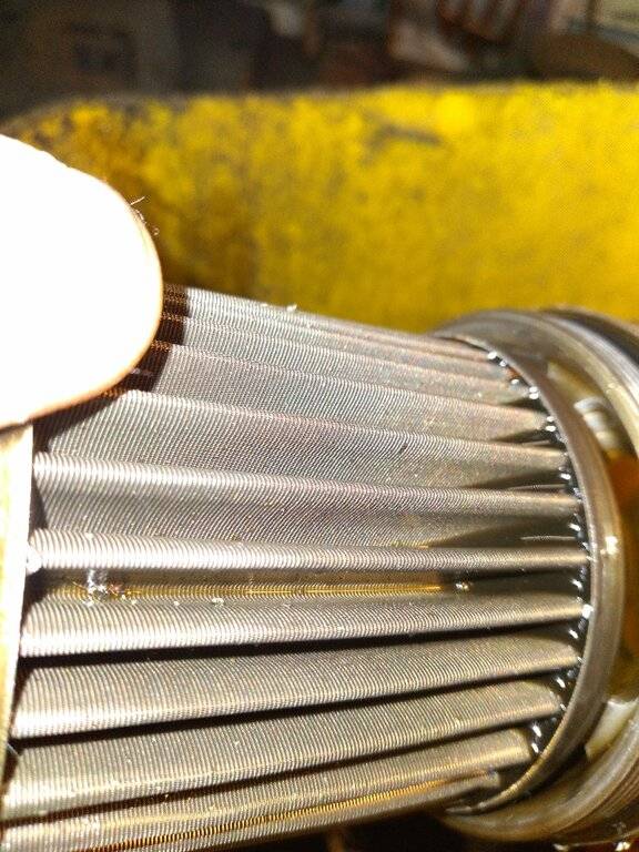

Helping a friend with a 361.
Engine supposed to be rebuilt. Spun cam with lifters on it, seen they all spun.

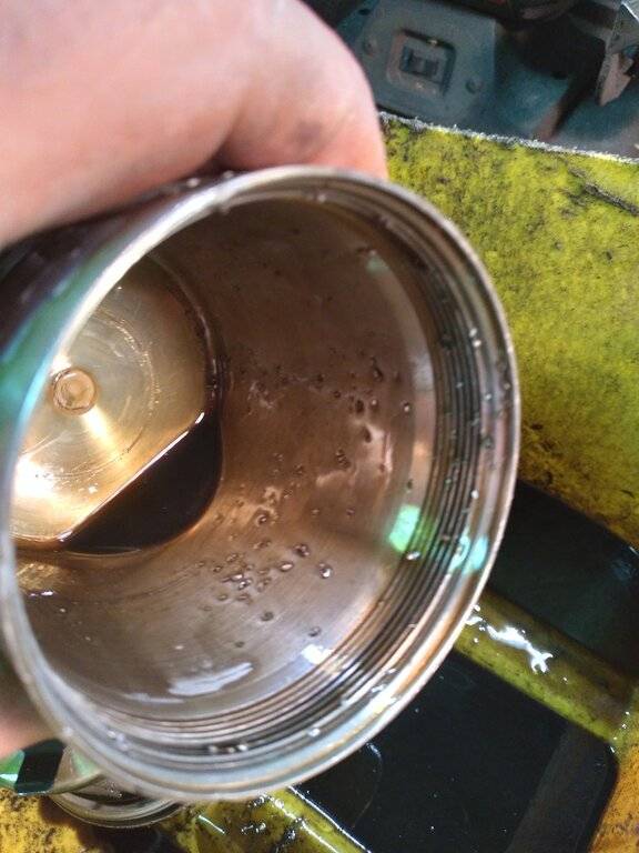

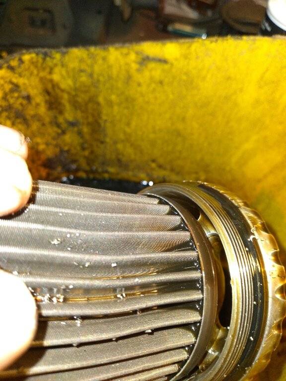

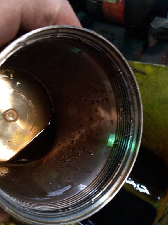

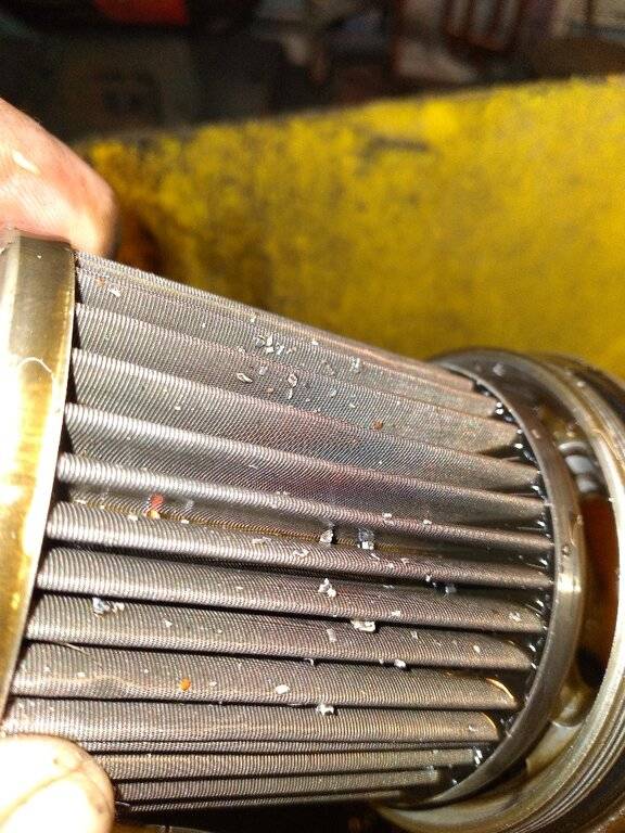

Broke the cam in, cut the oil filter, there was a lot of metal in there. Metal is chunky, non magnetic, silver.
Put a permanent cleanable oil filter on it, ran it a while, pictures show what is in it.
No strange noises, 35 PSI at idle hot.
Pulled valve covers, aluminum rockers all appear to be intact, right around .030 side play. No galling I can notice.
Where should I look next? My thought was to pull the pan and pop some main caps off, the material is really coarse though, not like I'd expect bearing material to be like.
The metal in the filter is pretty big to be bearing material unless there is a catastrophic failure underway. It also does not appear to be metal coming off the new camshaft as that would be smaller and magnetic. I would pull the rockers and check the shafts to be sure they were properly installed, if someone put the shafts in upside down, the rockers will not be oiling. You also might want to take a bore scope and check each cylinder for scoring from a failing piston, with the amount of metal in you filter, I would suspect the engine would be knocking if a piston was throwing that much metal. If you pull the pan, check the thrust surface of the main bearing with the thrust on the sides, an improperly finished crank has been known to eat the thrust bearing. The engine will have lots of crank end play if that has happened.

Did a shop build this or your friend? How clean did the shop clean it if they did it? Did your buddy follow up & clean before build if he did it? This looks like it's more like machining material than just break in material. I'm wondering how clean the whole block was before the start of rebuild by whomever? Good Luck

I don't think there's anything to do but pull the whole thing out and disassemble at this point. Don't run it anymore with all that crap in there. It's all over the crankcase and there's no way to clean it without complete disassembly.

With that amount of metal in the filter, you will want to be sure and inspect the gears on the oil pump as well.

As mentioned above I would check the rocker shafts. If they are ok, I would pull the oil pan and look for some sign. If I didn't find anything, then pull it and totally disassemble it.
I agree, that's swarf.
I'm agreeing with the above who think it's shrapnel left over from machining followed up by a piss-poor cleanup afterwards.

Engine started right up, no huge amounts of smoke, minimal blow by, no knocking. Ran it 20 minutes, cut open the first oil filter, noticed a lot of little garbage, and some of the aluminum? specks. Have been starting it and running it a bit, setting the carb etc, it probably ran it about 30 mins and checked that screen, as shown it the pics.

I am thinking those bits are leftover machine junk, or a piston going away. It's going to clean itself out or puke itself.

Judging by all this, I'd say take a deep breath, step back and start a new rebuild from square one all over again. Recycle what parts you can and all others new. Sad commentary all around! Good Luck
