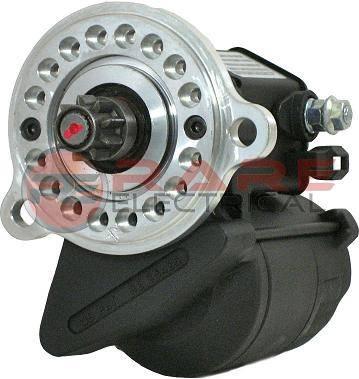

Mini Starter from 440 Source
I would recommend Mancini Racing and ask for a Denso. This is the starter used on the newer generations of Dodge trucks, vans etc.
I have had really good customer service with Mancini, and far the opposite from 440 Source.
The exact same ones from Mancini (~130 bucks) are on ebay for 75 - 85 bucks.
