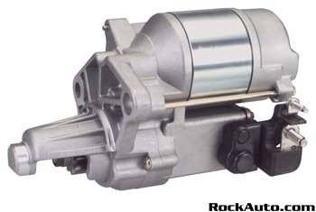

    Go to any parts jobber,order an el cheapo starter for a 1992 Dakota with 5.2L magnum.
    Should fit right in there.
    You may have to cut the plastic between the battery cable and tiny wire that bolts to the starter.
    I have two cars with mini starters and no machining
    • Agree Agree x 2

    I saw that a couple of guys did this in the posts I was able to find and be damned if those starters don't look exactly like the Summit mini torque starter I bought. Correct me if I'm wrong, but this is the starter you mentioned from a Dakota:
    Here is the one I currently have from Summit:
    [​IMG]
    Worth a gamble/return in your estimation? Thanks again all for the help.
    Mike

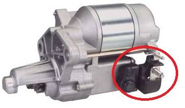

    And this is the piece you need to remove to allow a space between the positive post and the block.
    • Agree Agree x 3
