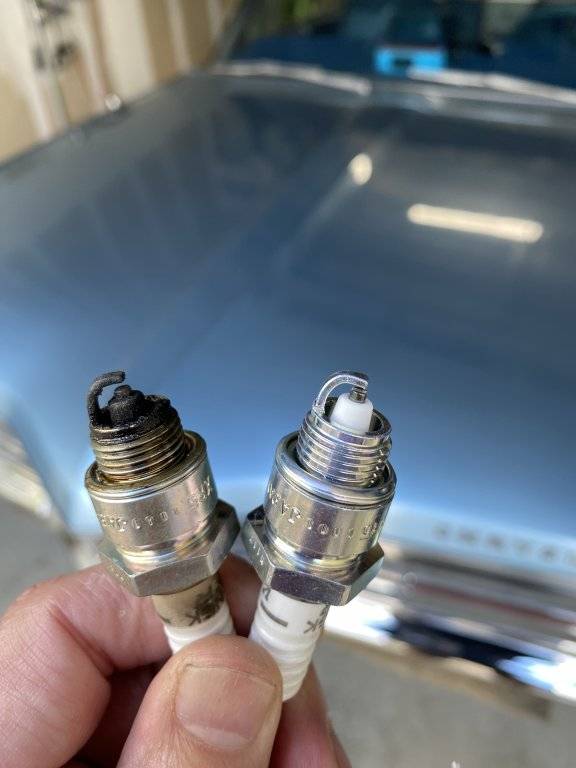

Welp…. That explains it!
Clearly long overdue for some new plugs.
The ones on the passenger side were definitely worse off than the driver side. The two closest to the fire wall were the worst (I can’t remember the cylinder numbers off the top of my head).
It started misfiring on the ride home last Sunday, and since it has been probably 6 years since I replaced the plugs, I figured it was worth the effort even if it weren’t the plugs. Admittedly, one of the plug wires did feel a bit loose when I went to unplug it, so that very well may have been the cause of the misfiring too.
I was prepared to change out the cap and rotor as well, but since the plugs did the trick, I am going to hold off on that for now and at least have the spares at the ready.
