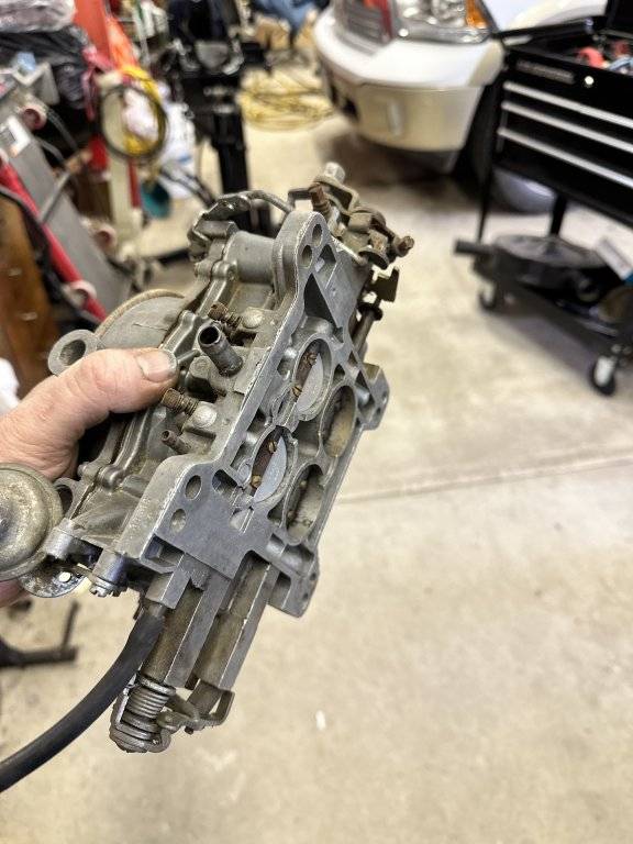

I have it so close. next dilemma. the carb is MIA. The only thing we can guess is that he either sent or took it to someone to rebuild and then when he got sick it got forgotten....
so I found another crusty looking Carter AFB3856S and will be rebuilding it. Any recommendations on the best kits?

So, if anyone is a specialist at Carters that may have a carb from Mike Muir in Minnesota, I'd love to find it. Otherwise I work on the other one!

Today she ran for the first time in years, got the carb set close I think...... timing is close also I think.
Has a slight miss, but I have a couple cracked plug boots, and the cap/rotor were what was on it, I think it's time to replace all 3 of those.
