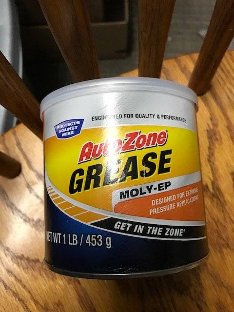

OK I have a tub of this moly. I'll stop on the way to the garage in the morning and pick up the Rotella T (I used to run this in my VW TDI), some straight axle grease, an oil can, vasoline, MEK, silicone, and the anti seize.
I have a copy of Don Taylor's book and we'll follow it by the letter.

That ain't breakin lube......... Or maybe it'll work fine - I'm not really positive, but I wouldn't use that inside my engine.

AutoZone sells the Lucas Oil semi synthetic assembly lube. You can use this product to lube the cam and all bearings etc., works on pretty much anything inside the engine. It is a high zinc, very slick product and reasonably priced. If your camshaft came with a manufacturer's break in lube, use that, otherwise use the Lucas Oil product.

I'll look for the Lucas assembly lube. The book says to "coat all cam lobes and cam bearing surfaces with moly (or white lithium) grease" so we assumed we had what we needed.
Engines used to be put together that way, How old is the book that you are using? Today's synthetic assembly lubricants have much better cling, higher melt points and a much lower coefficient of friction on moving parts.

Just as a follow up, the white lithium grease was used by engine builders on camshafts for decades and does work. I switched to the synthetic stuff because it was in my view superior and a lot less messy to use. Either will work for you.
