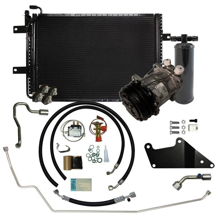

As some or many may know my stepfather and I are mainly into the C-bodies, but my stepfather also has one B-body and is building a 1966 Dodge Charger with a big block 383. Here is the build thread on FBBO if anyone wants to follow it. So It Begins, 1966 Charger Restification.. We have the engine mainly together and basically all we have left is the air conditioning, condenser, and radiator. I maybe missing a couple of things too if I remember right, anyway our plan is to put modern air conditioning in and NOT use the big and heavy RV2 to save a bit of weight and get cooler air. We are thinking of buying the Stage 2 Performance Kit from Original Air for $850.00, here is a picture and the link. We are looking for suggestions opinions and what have you about modern air conditioning prices and such, is there anything a bit cheaper than $850.00 with what we are looking for. Anybody? Any help, knowledge etc would be greatly appreciated. Thanks in advance everyone
https://www.originalair.com/66-70-b...0-134a-engine-compartment-upgrade-kit-stage-2
One thing I forgot to mention, we would like to keep the interior controls and dash ducting original and not mess with them.
