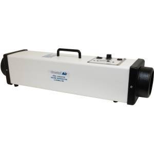

we found this unit which has more power than the ones generally available to rent, so we bought it.
its made in Canada, no chinesium.
i split the cost of it with my buddy that i go on car adventures with, he has alot more cars than i do - hes got so many that some dont get driven for a couple of years so they can start to get abit whiffy......
we have been really happy with the results, much better than from the rental units. at least double the output if not triple.
my 72 Monaco had been parked in a shed from 96 to 2022 when i got it, it had a pretty nasty odour from mice/mold.
did a couple of treatments for a couple of days and nearly a year later there is still no smell.
and thats with the carpet and headliner still in place.
PRO 1100 ozone generator, 1100mg/hr, 6 yr warranty. Timer, voltage, and adjustment options.

It works just fine, no probs, used it last week in an 81 trans am with cloth interior which had been parked for 15 yrs.
the 72 Monaco's interior was a bit musty smelling since I did it last year, but no mouse pee stink so I gave it another treatment.
pretty happy with the machine
