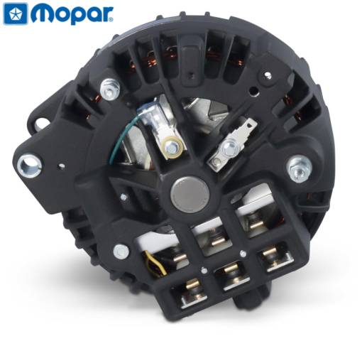

Has anyone upgraded their alternator to the Mopar 110 Amp Alternator and if so can you wire it up the same as stock or do you have to upgrade the wiring? Not a wirirng genius and I'd like to get something I can install myself. Thanks Fellas

You are going to have to upgrade the wiring, bypass the alternator gauge, switch to a 1970 & up voltage regulator and more. You should be fine with a 50-60 amp alternator, but even with that, you should check your wiring. Just my 2 cents.

Then you don't need that alternator.
LED bulbs draw a lot less current and the headlights won't draw any more than the stock ones. The only extra is the stereo/amplifier. The stereo head unit won't draw more than stock... In fact probably less. Depends on the size of the amp, but it's easy to figure out using (gasp!) Ohm's law.
wattage/voltage = amperage
So.... A 300 watt amp running on 12 volts (figuring the voltage low) gives you a 25 amp draw. That's not all that much... That's also when you are running the volume up... So at normal listening levels, you aren't drawing that much.
IMHO, I'd go with 50-60 amp alternator, do the ammeter bypass, run a power cable for the amp from the starter or directly from the battery. My car is basically set up this way. I have a powered sub and a 4 channel Polk Audio amp and I have no problems.
There's nothing wrong with using the 110 amp alternator.... The alternator will only put out what it needs and that's all. It's just not needed.
