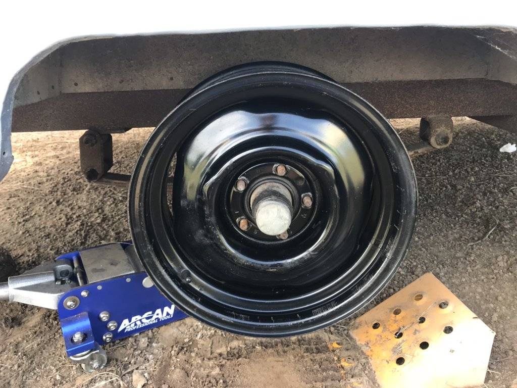

My wife and I bought a vintage "canned ham" trailer a few years ago and I'm finally starting to work on it. It's a '61 Aloha, weighs about 2000 lbs., loaded.

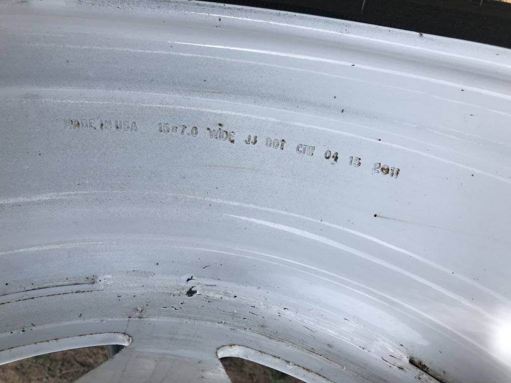

First thing is putting some better looking wheels on the thing. It came with the standard "boat trailer" type of wheels (not original to the trailer), white with the triangle shaped slots. While functional, they look bad. These are 15 x 7 JJ wheels.
Fortunately the lug pattern is 5 on 4-1/2". And I already have a Mopar wheel from my 73 NY'er trunk spare. It is 15 x 6 JJ.
And I recently bought another Mopar wheel that I discovered is 15 x 6-1/2" JJ, when I compared it to my 73 spare. Dang!
So, could I safely use a 15 x 6 on one side and 15 x 6-1/2 on the other? Would it make any difference? Or should they be exactly matching widths? Or should I scrap them and try to find 15 x 7s?
The tires are good, they're ST205-75-R15s, rated for extra load.
Existing wheels:
73 NY spare wheel test fit on trailer- 15 x 6

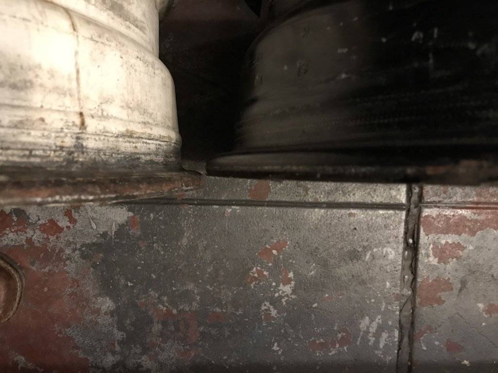

two mopar wheels rim to rim
Note the difference in width
