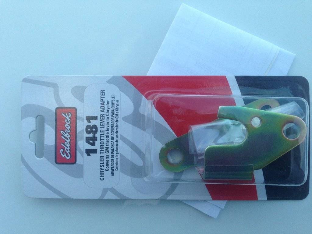

Go with the Edelbrock 600 performer with the 1481 Chrysler linkage adaptor. My car works extremely well with this combination This adapter allows easy setup of your kickdown and throttle cable

Thanks, someone else had mentioned that in the earlier post I made

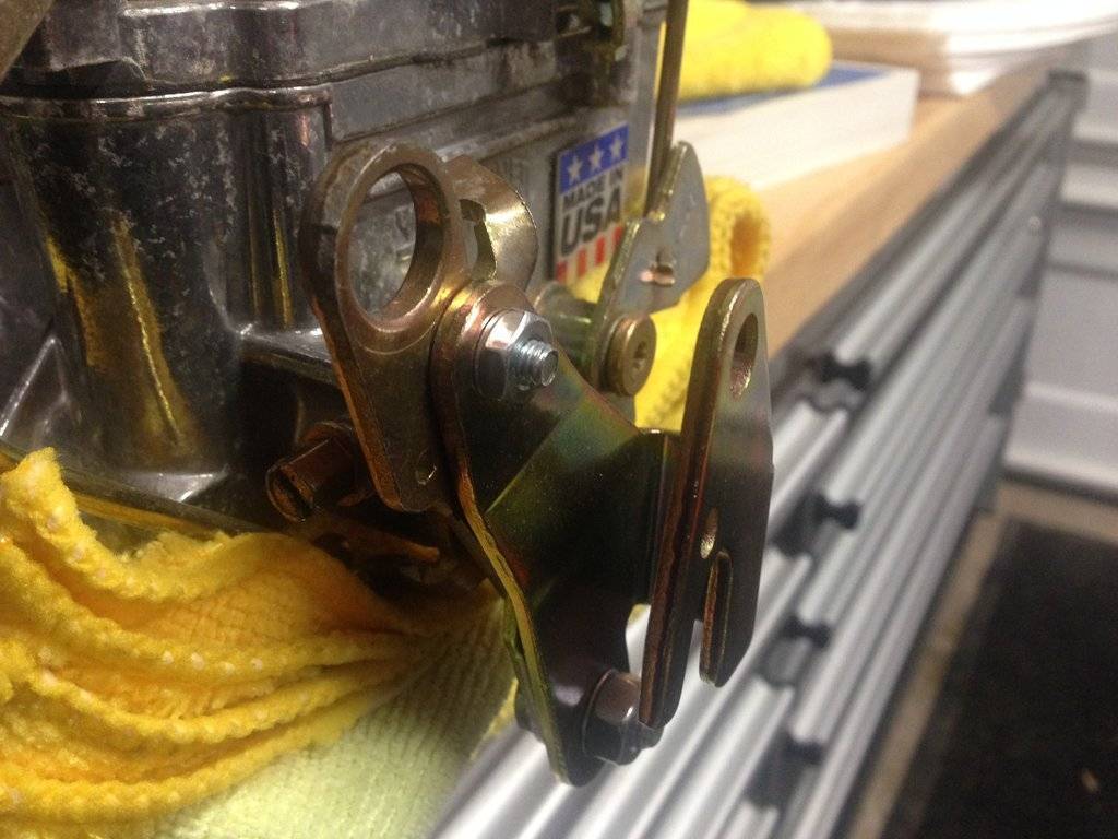

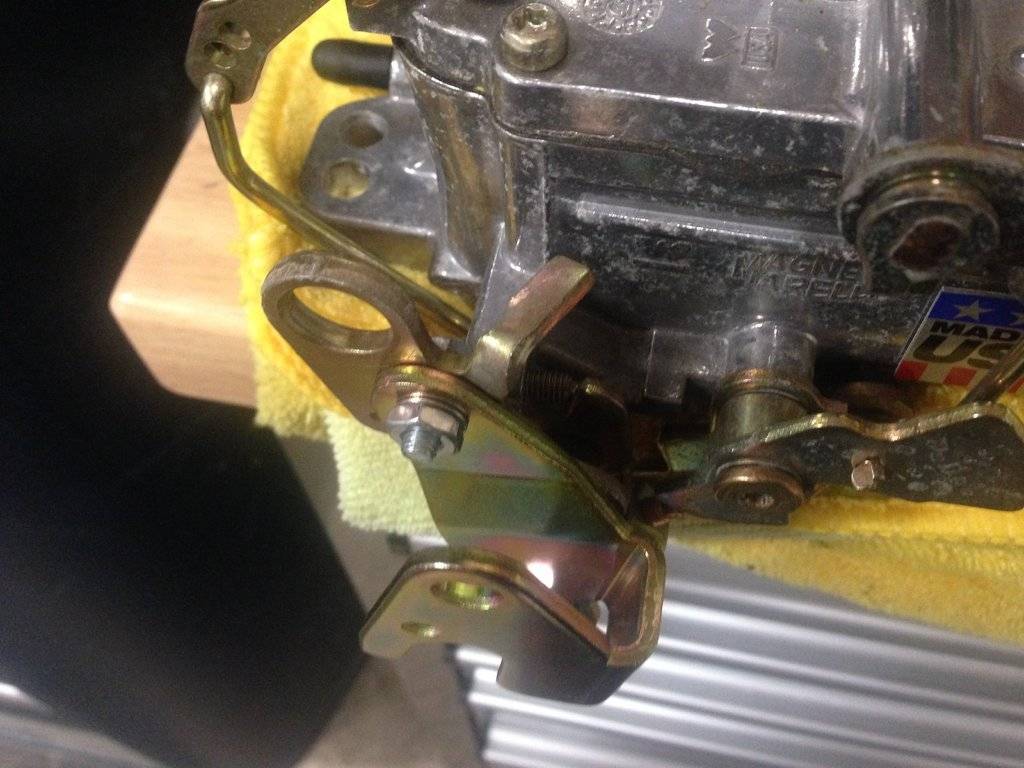

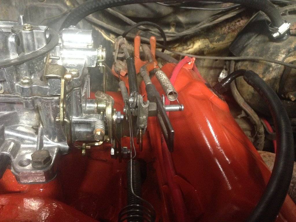

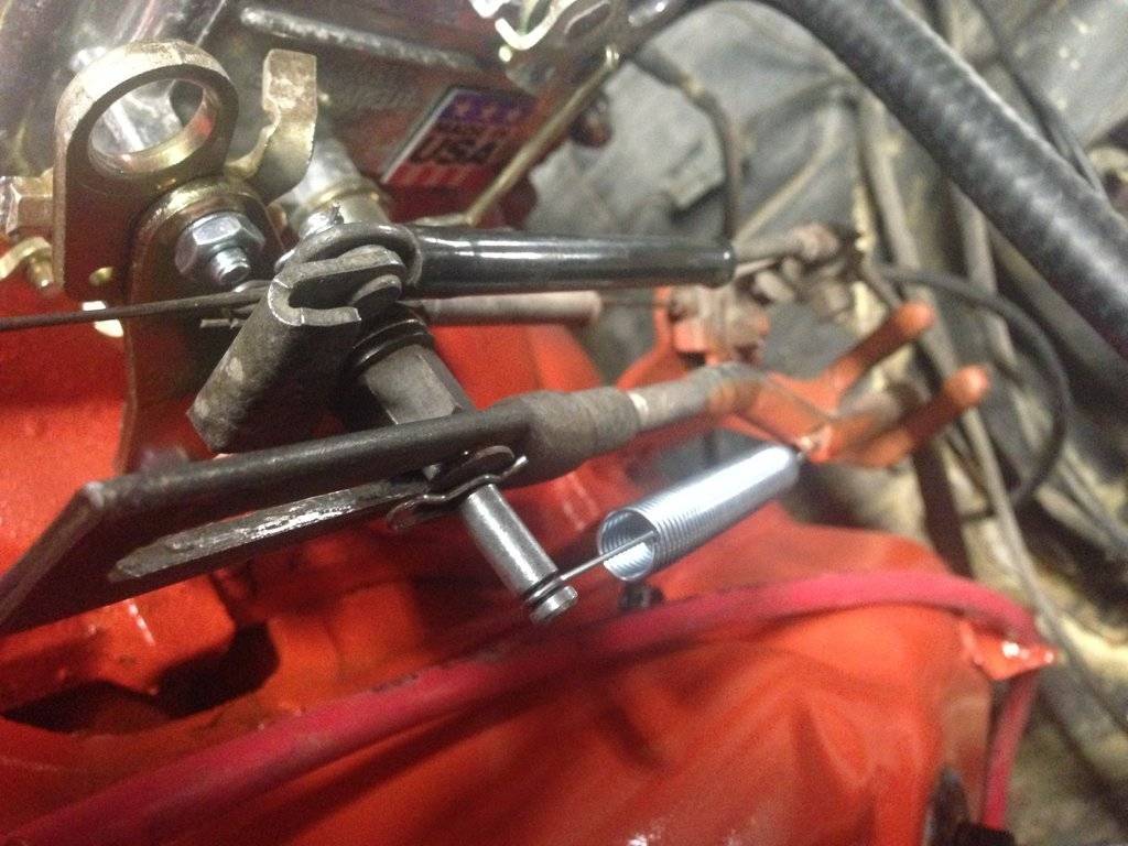

Here are some pictures of when I was installing my n

I somehow messed up the quotes etc in that post. Here is what I meant to add with that picture:
Awesome that will be helpful. I just ordered the 1481 kit above. With that, If i use the edelbrock 383 aluminum intake, will i also need this??
I don't know if you need that bracket I stayed with the factory 4 barrel intake. My reason is I wanted my Cruise control ,kick down , throttle to use the factory brackets , they I worked great before I installed the new carb and they work great now ! If it ain't broke don't fix it . I've put 20,000 miles on the car since then and have had no problems with it.
