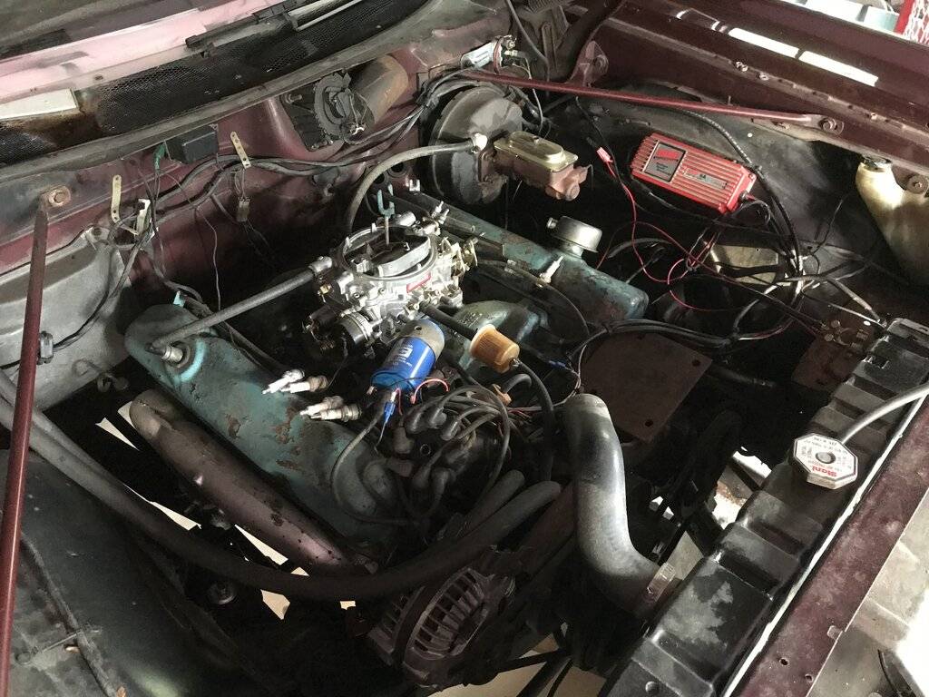

So I still have yet to hear my motor turn over never mind purr. After unsiezing it I had thought my battery was too far gone to turn over my motor so I purchased a brand new 24 series battery... hooked it up, went to start it and to my dismay the same result as with the "bad" battery I replaced. Starter "clicks" b ut nothing else... no attempt to move any part of the motor... just silence. What do I do next? Lights are full bright with only a slight "dim" when I go to start the motor. very frustrated that I cannot figure this out.... thanks in advance!!!
You may have a bad starter relay with corroded points. Try jumping the two big wires on the relay together to see if it will turn over. If it still will not turn over, odds are the starter is bad. Starter relay on your vehicle is just above the brake booster. Be sure all connections to the relay are tight and free from corrosion. If the car turns over using this method, the starter is ok and the problem lies in the wiring elsewhere. Check the fusible link, firewall plug and the ignition switch. Cars that sit long enough to stick the engine often have corrosion issues elsewhere. Be sure the negative terminal where it connects to the block is free from corrosion and tight. Note your coil wire to the distributor is disconnected. Looks like the car had a dealer add on A/C unit with a York compressor at some point.

The square mounting plate with four holes on the top of the intake looks to be a York compressor mount. The after market A/C was an under dash mount that did not use the factory A/C vents.
