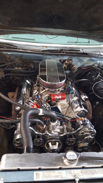

I used a 6AL on the driver's inner fender, Blaster 2 coil, stock distributor.

I have the MSD billet distributor with electronic ignition. Combined with the 6AL box and the Blaster 2 coil and I have never had an ounce of ignition problems.
