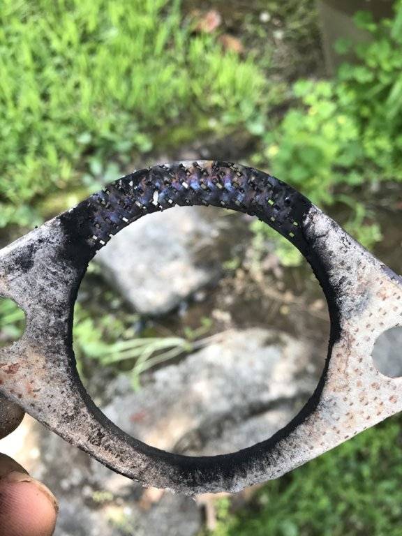

    Stock muffler installed. Muffler guy said the tailpipe was fine. He did find a leak where manifold and pipe meet. He said the pipe was warped and recommended stacking 2 gaskets.
    Took him 20 minutes. $95 total. Reviews said he fast and inexpensive. I am very happy with the muffler.

    Muffler dude said it was burned out. Have 2 to stack as he recommended.

    Yeah, that gasket's toast. What brand/type of stock muffler did they throw on it?

    Turbo but I don’t recall the number. It is on the receipt. Has a slight, mellow rumble but not loud. He said it was as close to stock as he had.
    Just finished the double gaskets on the exhaust.
