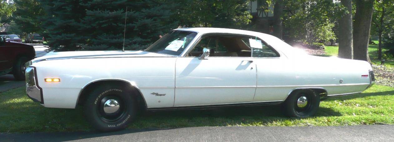

I know it is not broke, but I wonder if a MSD-6AL can help me
(and my newly built 493 mild stroker) out when I try to suprise
some one off the line.
All advise is welcome.
Yes, I am a stoplight racer 0 to 50 mph only! and I know
it wieghs 2 + TONS....
BUT IS KEEPS ME OUT OF THE BAR!
