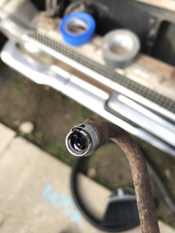

Nothing to exciting for me lately. I’m sure I’ve said in the beginning. This will be a slow build. Removed a few items today to rebuild and/or clean up. Also popped the fuel line off today and got a nice dark surprise. I figured as much though when it come to my estimates of how long it’s been sitting.

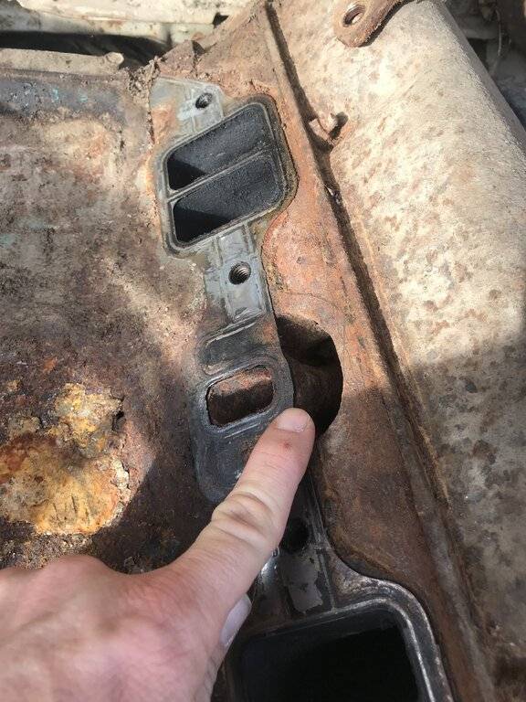

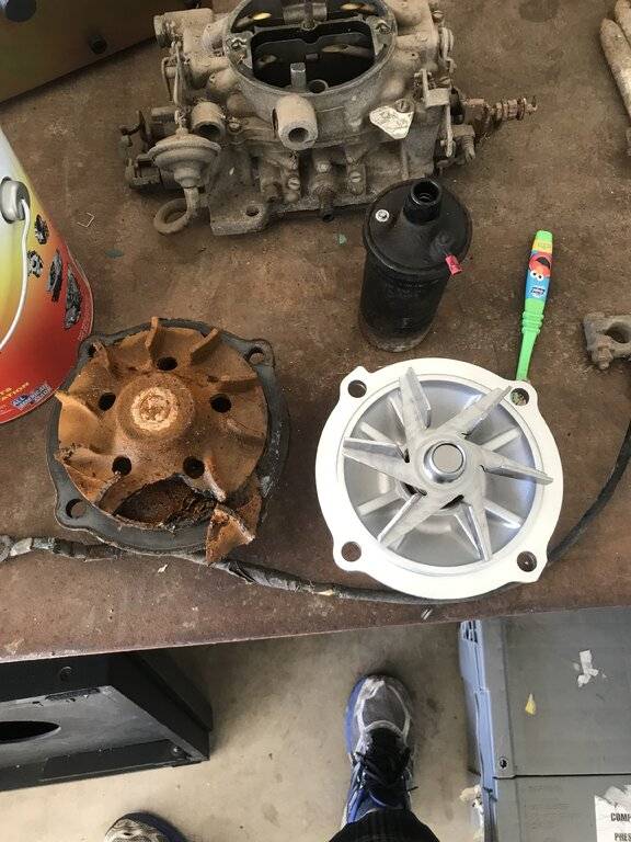

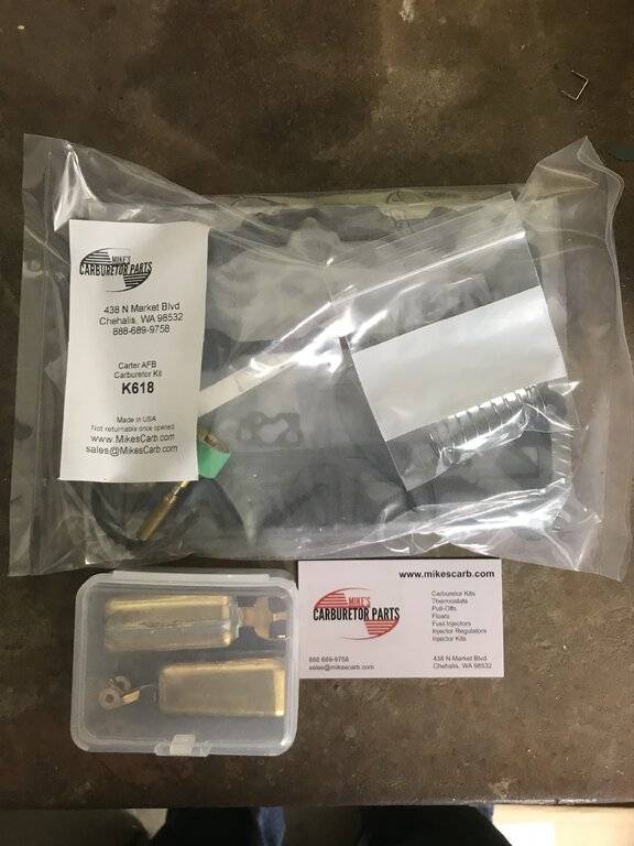

Few more parts arrived this week. Carburetor rebuild kit from mikes carburetors. New coil (positive terminal broke off original), one of two fuel filters. Figured I would go through a few filters even if I “think” I have the lines all cleaned out. Still waiting for the new fuel pump to arrive. Also need to order a new valley pan gasket set. Valley is actually rotted on the front end of the motor.

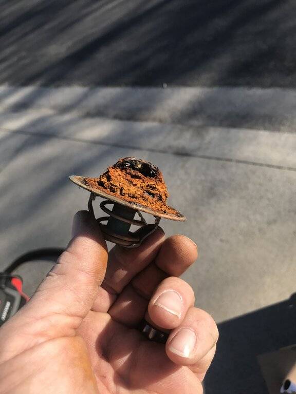

Seems that water content was a little high from who ever last had coolant in the motor. Or maybe straight water who knows. Water pump housing was pretty nasty inside. The impeller actually broke as I was prying the flanges on the pump itself. So I don’t need to worry about pieces running through the cooling system thankfully.

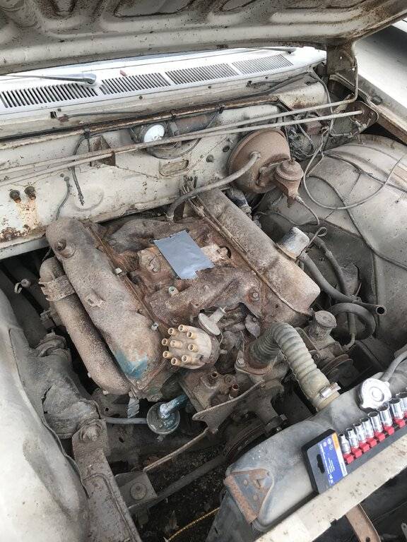

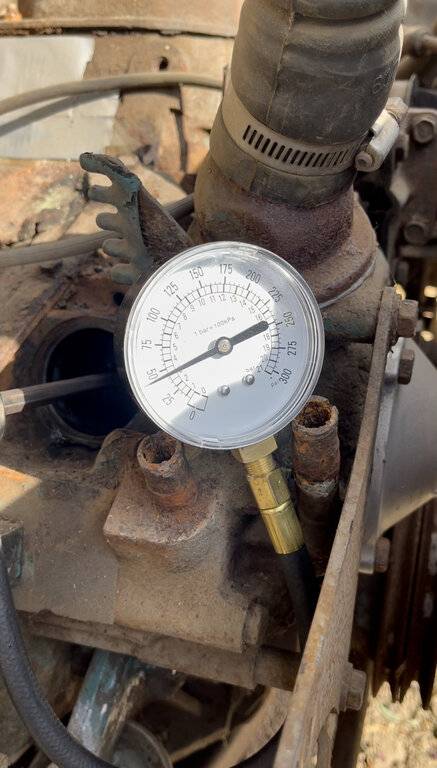

Well after checking things over. The motor turns over freely. All the valve train moves freely. The plugs in it looked good. And now after a oil and filter change I know the engine builds oil pressure still.
