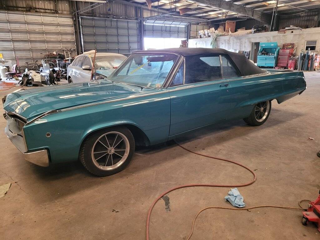

Hey guys, I figured I would start a build thread since I plan to do a bit of work to this ride. I purchased this 68 Polara 4 door hardtop 383 from my good friend in early January. He had already done quite a bit of work to it. My first car was a 1966 Impala that I daily drove for 4 years. I sold it 12 years ago and I've missed it ever since. Being a mopar lover I had to buy this Dodge as it's very similar to my Impala but better in every way.
  • Older 15”x7” mopar police wheels with brand new 235/75/15 tires.
  • Replaced gas tank, sending unit, fuel line, fuel pump and rebuilt 600cfm edelbrock carb.
  • 4-barrel conversion (69 factory 4-barrel intake) with proper kickdown brackets/linkage.
  • New brake lines from inline tube, new master and booster.
  • New alternator and voltage regulator
  • Mancini racing pulleys
  • Saginaw power steering pump conversion.
  • Replaced hood torsion bars due to one being broken.
  • New 26” radiator, hoses, thermostat, and trans cooler lines from inline tube. (Car runs dead middle of the temp gauge when in summer traffic.)
  • New points, condenser, cap, rotors, wires.
  • New headlight dimmer thumbwheel switch.
  • New kyb shocks, sway bar endlinks, and idler arm.
  • Floor repaired and new plush cut carpet from ACC.
  • New battery, new battery tray with hold down, new positive and negative cables.
Now that all that is out of the way, I'll talk about my plans for this car. I want this to be a fun spring-summer-fall cruiser. Not perfect paint but presentable. Mechanically everything is good to go except maybe a brake rebuild. The electrical needs some upgrades and mods. I've already installed a new stereo which I will detail in a later post in this thread.

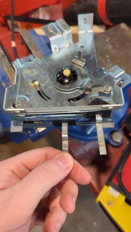

Check sometimes they just fall off the post on the heater core housing
Thanks for the tip. Unfortunately the cables and everything are hooked up, just very stiff, which caused the plastic clips on the knobs to break, and now they flop around.

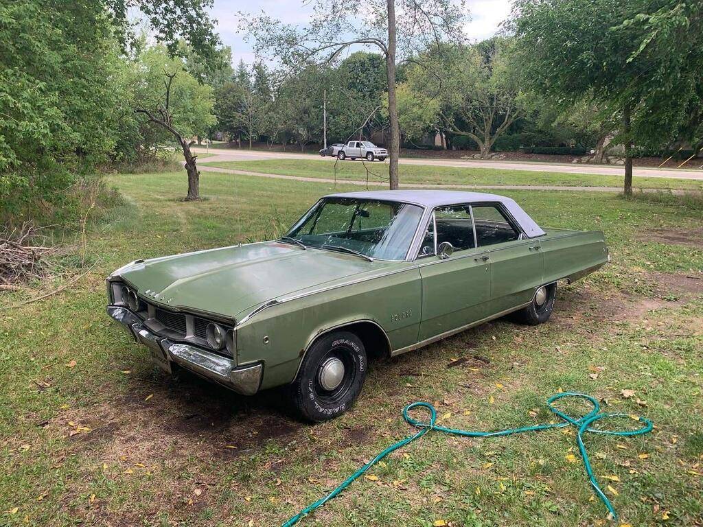

Got some warmish weather this week. Fired up the Polara and backed it out into the sun for some pictures before she goes under the knife this weekend. We're digging into the back window to repair some rust.
Here's a short video I took of it:
And some more pictures:
