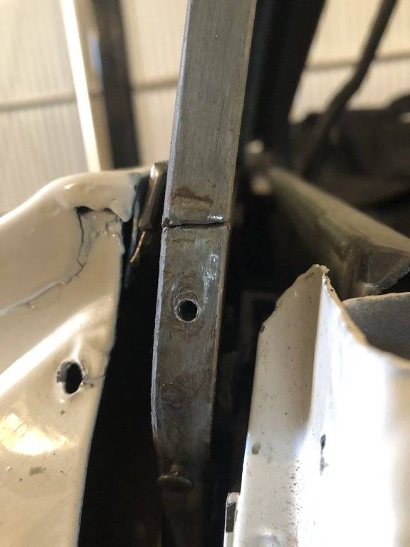

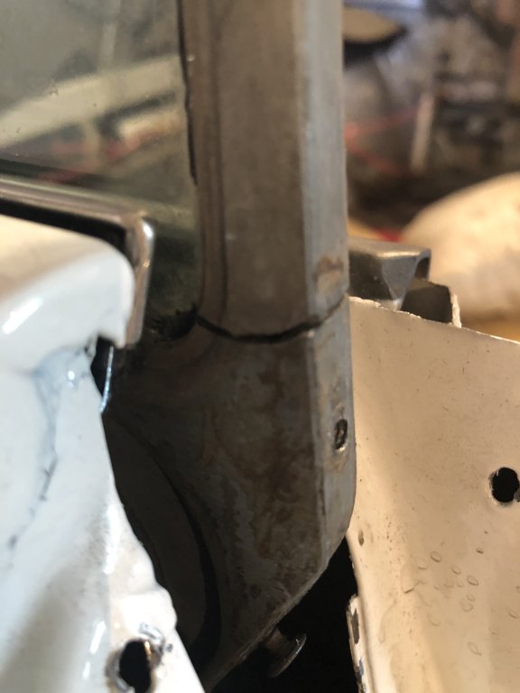

That made the glass more secure in the bottom frame, but it was still excessive loose in the inboard outboard direction so the window could not be adjusted to roll up well. After staring at it a while I noticed that the front rail that holds the forward trim and seal should have been attached to the bottom frame but was broken loose. Not surprising because it was pretty thin cast metal. You can see the break line in first two of the attached photos.

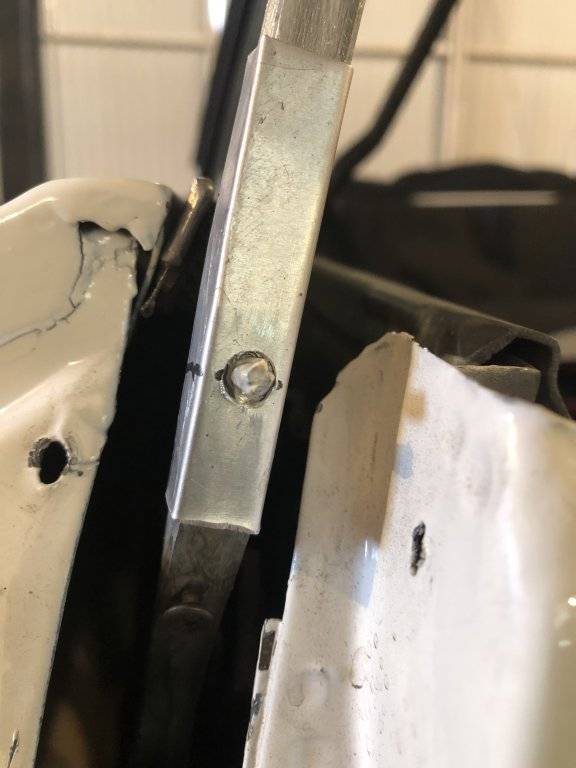

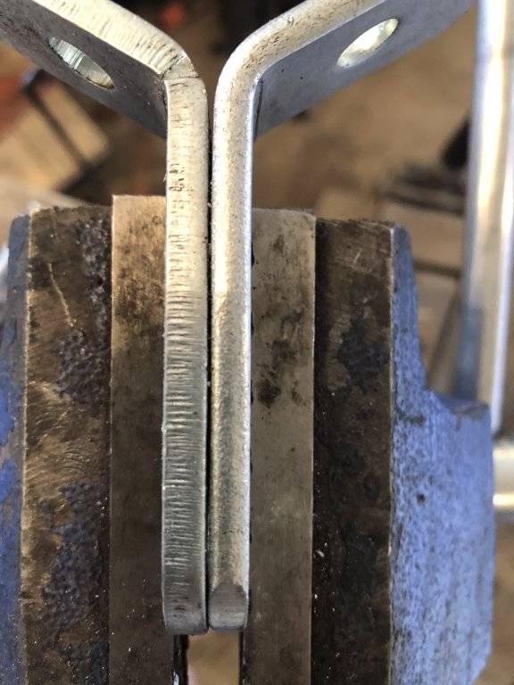

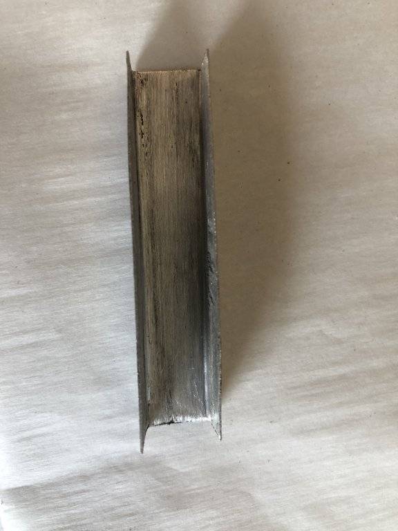

My fix was to fabricate a U shaped patch out of some 24 gauge (20 thousands) aluminum sheet scrape that I had available. In the third picture you can see the pieces of metal I clamped into a vise to do the forming. The metal was selected to be the same width as the frame that needed patching and made a good hard sharp edge surface to do the forming. The forth picture is the almost completed patch. The only thing left to do was drill a hole for the lowest screw that holds the trim pieces in place. In the last picture you can see the final fit up before JB welding the patch in place. The screw thread sticking out was to keep the screw hole open and was greased lightly so the epoxy wouldn’t stick to it.
