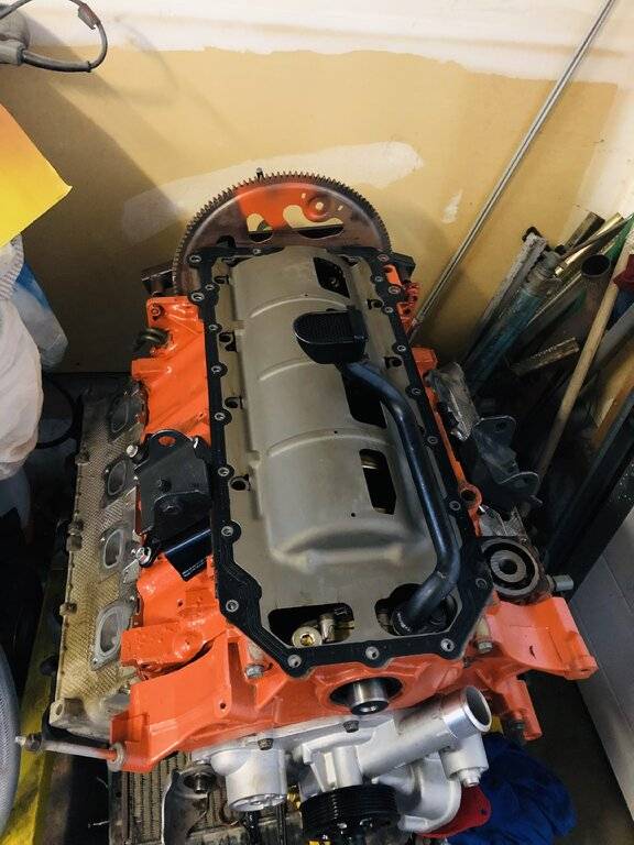

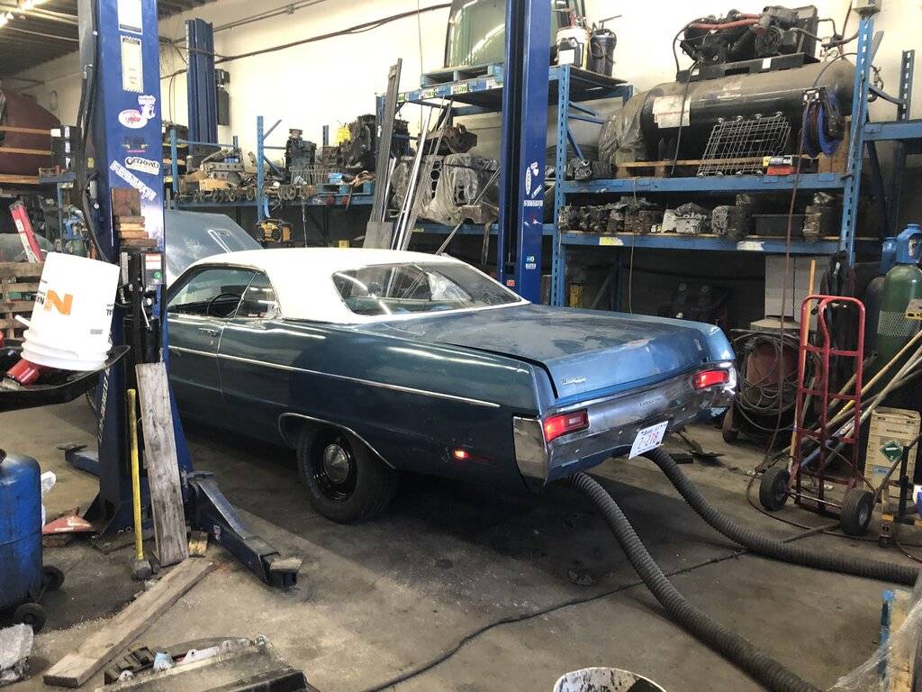

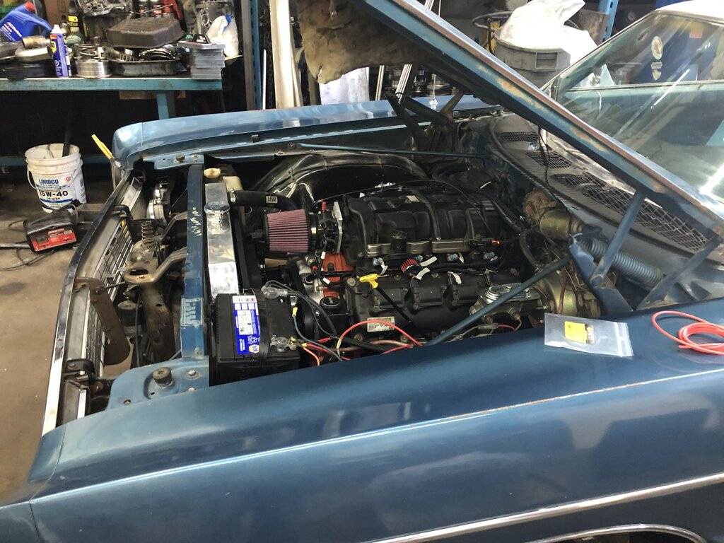

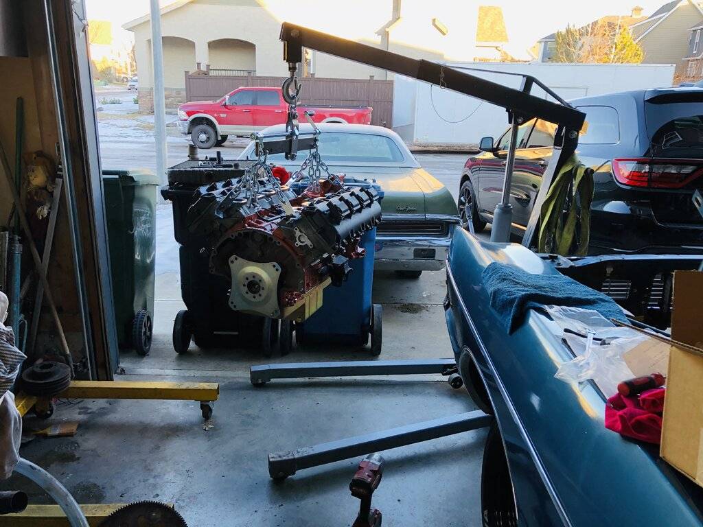

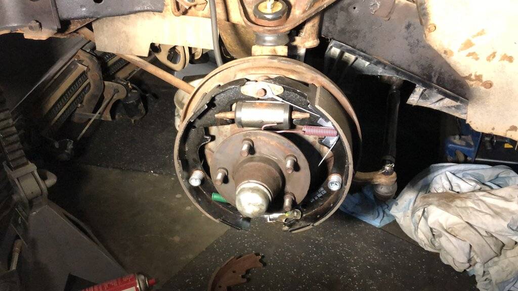

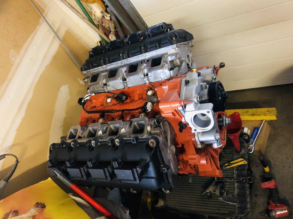

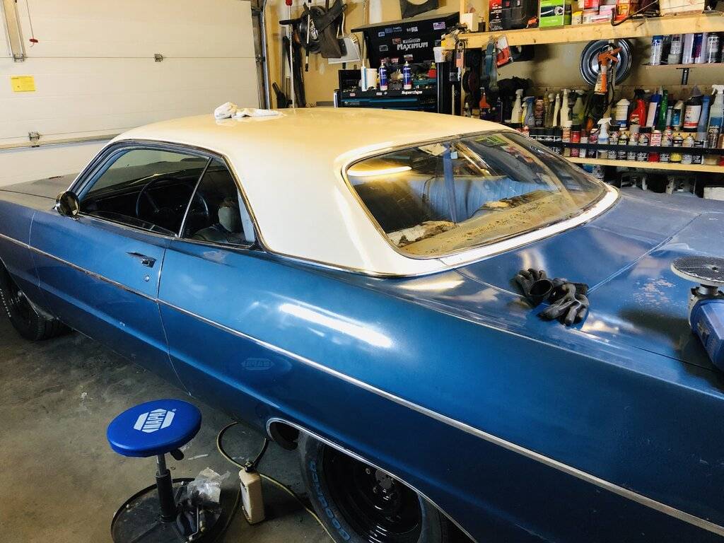

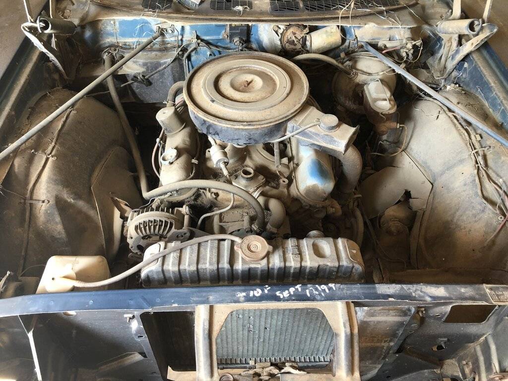

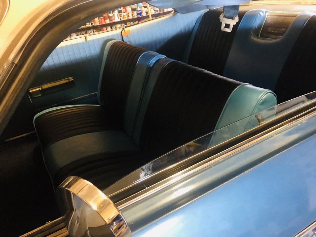

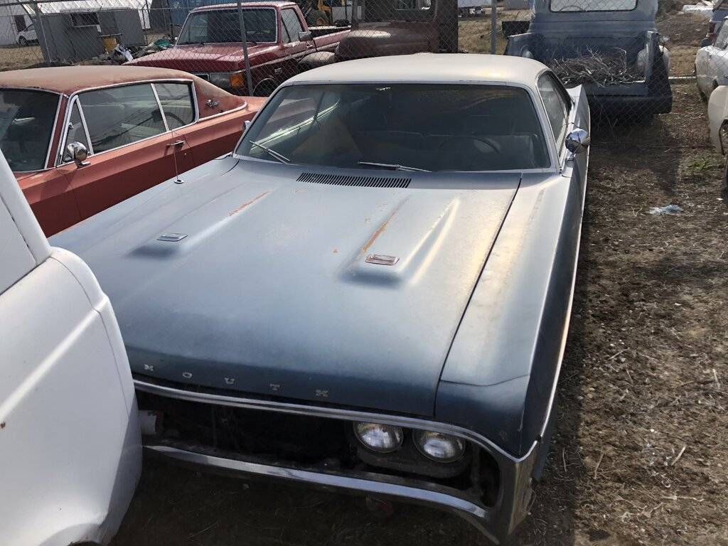

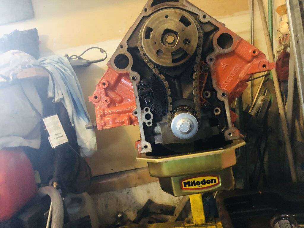

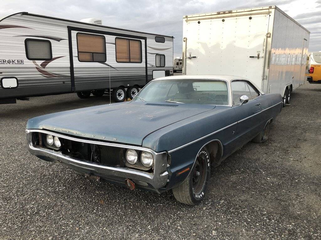

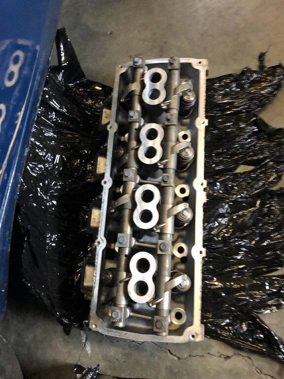

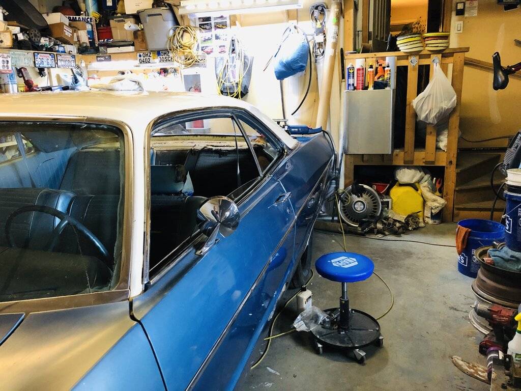

    That’s my B7 blue 1970 Plymouth Fury with factory painted roof.

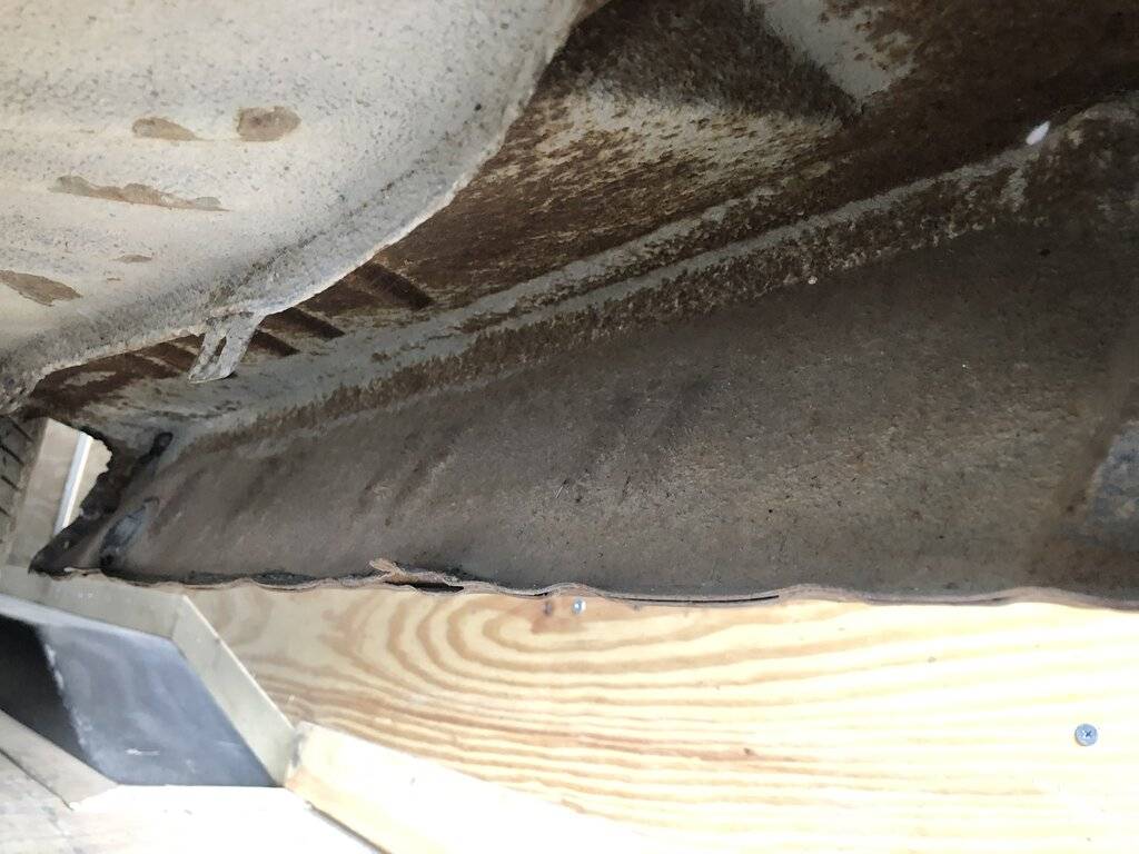

    I rescued the car last summer from a yard not far from my house, is all original paint and is super solid and has a nice patina in my eyes, the Fury was the last time on the road in 1992 and when I got the car it was all original with the dry sized 318 in it and a sun backed interior no keys and broken steering column, after I picked the car up it was sitting in one of my storage places for a few months and I not even looked at it.
    And one day it came to my head that I have to go and have a closer look at the car and have to decide what I will do with it, I was not sure if I will part it out or not when I had a closer look at it I decided the car was to nice and I came up with the idea to build a fast Fury that can be driven every day and also on long road trips with good fuel mileage.
    I went ahead and redid the whole suspension and brakes new fuel tank from Holley with internal fuel pump new Magnaflow stainless steel exhaust system, new 727 trans with 2800 stall and stage 2 shift kit the engine is an upgraded eagle Hemi and for sure new interior. 4BAB44E6-8E11-47F1-A3FF-6C9828BD66B7.jpeg 028AA31B-2D8C-45C9-B500-EB3AFF89BD04.jpeg C8651290-159A-47CD-BD2C-EBAEBB32512F.jpeg A28D890F-B9A0-4D25-AAFE-F184848B20F5.jpeg 1261FC97-FEB6-4EFC-A3CD-6B6C7A04A0D3.jpeg 4A5AF661-B629-4B97-927B-2538058A24C0.jpeg 2870C43F-A509-4BD6-852E-93933B3F6C63.jpeg 0E96BA23-915F-43C2-BB7E-8F275EFDE436.jpeg 423158E7-B168-40A3-8F24-1C65CDF4557B.jpeg

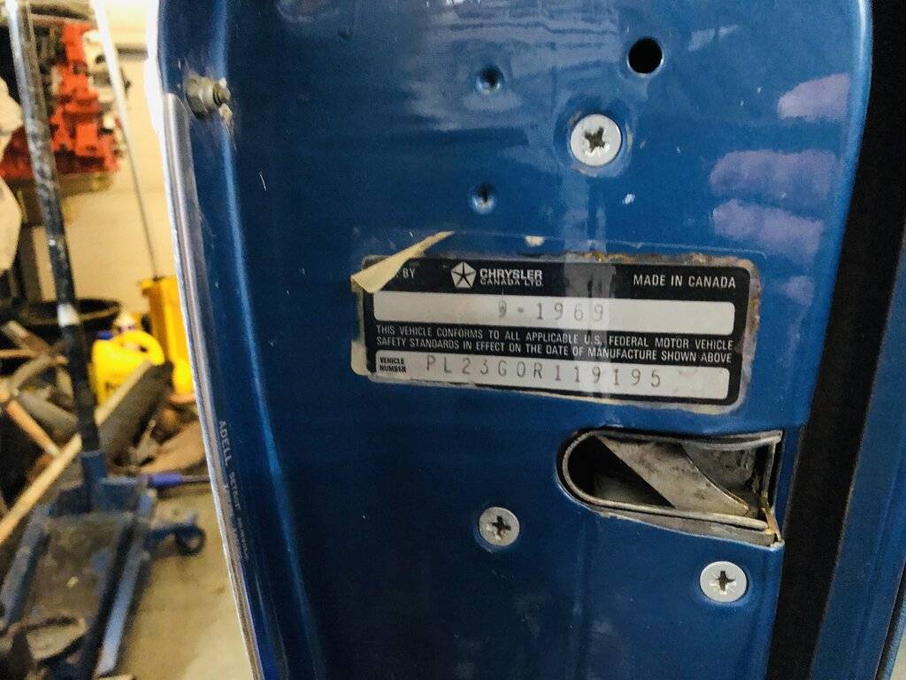

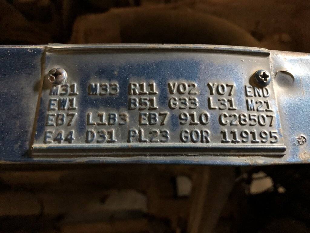

    Thank you for posting about PL23G0R119195 — cool EB7 / EW1 painted roof!

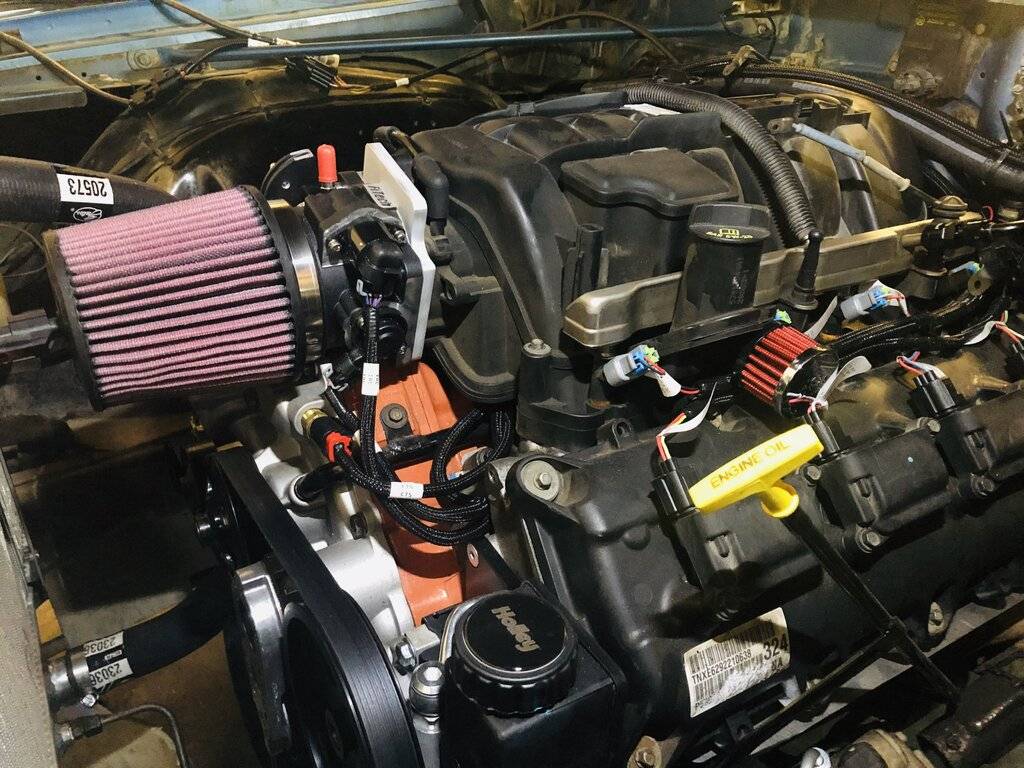

    (2800 stall speed and "good fuel economy on trips"?)

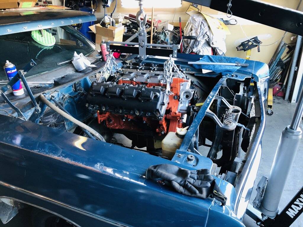

    Car looks goooood. What was necessary to mate the Gen III Hemi/727 to the car? What computer and such? Just curious.
    Thanks,
    CBODY67

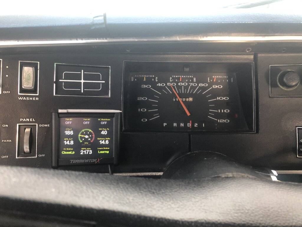

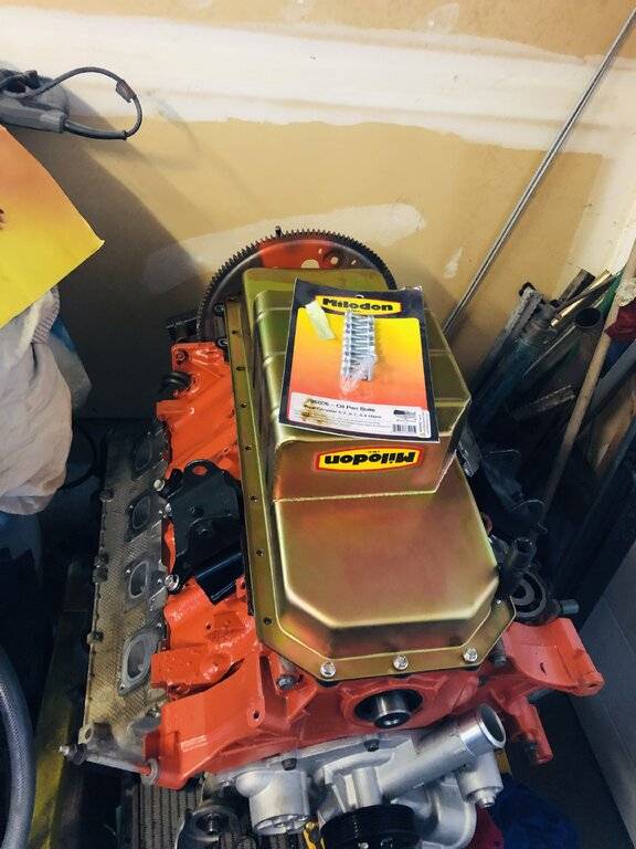

    The new style hemis bolt right up to the 727 transmissions, the engine mounts and power steering pump is from Holley and I use the Holley Terminator X system with VVT control there is quite a bit of fabrication involved but nothing to crazy. Change the oil drain plug location on the Milodon oil pan , fabricate your own trans mount, fabricate the exhaust system and play around with the alternator.
    I used an 92mm LS throttle body and made my own lockdown cable and bracket and same with gas paddle cable.
    The stall of the tc has nothing to do with the fuel mileage at the end, I’m not done with the Fury yet it will see a 6 speed Tremec in the future and maybe a Dana with 3:23 gears.
    • Like Like x 2

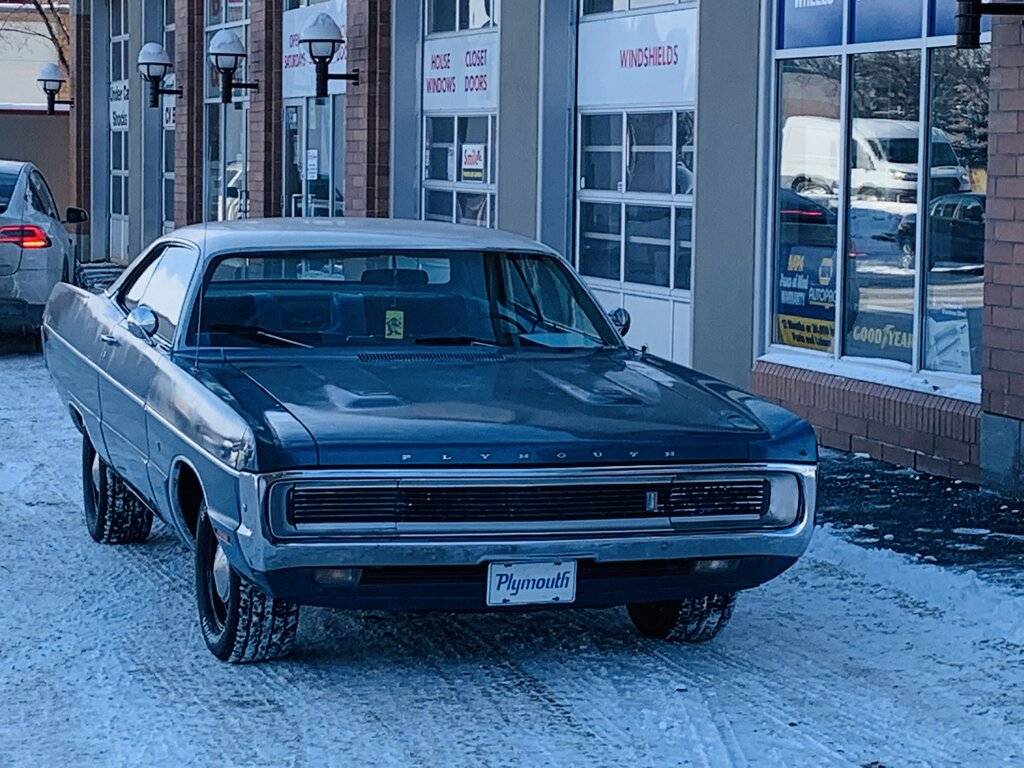

    Took the Fury for a drive today and I have to say I’m pretty impressed with the performance E7FB801E-42DE-4027-814D-12B365387FC8.jpeg 1E5E2B9D-374A-4829-8E4B-F03C487501CB.jpeg
