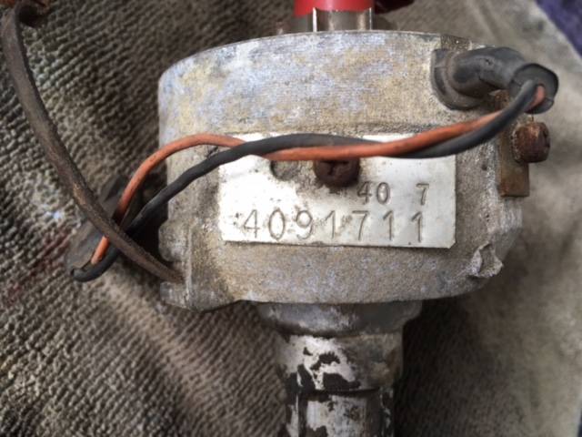

Well I fixed it. I checked everything & could find nothing wrong so I pulled a distributor from an old 440 motorhome engine I have taking up space in the shop. Surprised to see it didn’t have a vacuum advance canister mounted to it. Also it was about 3/16 shorter than the dizzy I pulled out of the D440. Im not sure why. I went on & put it in. Kinda guessed at the timing. If fired right up & seeme to run quite well. Put my vacuum gauge on it. Plugged the old port from the old dizzy. Put a timming light on it. I have it at 14 BTDC 18 inches 850 RPM based on tach. Seemed to idle very good. Went down the road. Great throttle response. Got out to the highway. The light had the traffic stopped. Pulled out about the time the light changed. Let her rip. Looked back & a newer BMW was gaining try to catch me. Went all the way to the floor & wow does it run. Looked back & the BMW backed off. I honestly believe it’s faster than it was. It was building RPM fast. Tach went past 4000 & I let off. Pretty pleased.

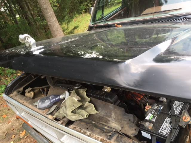

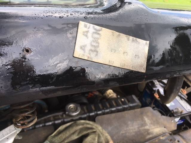

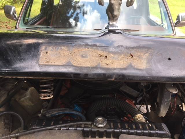

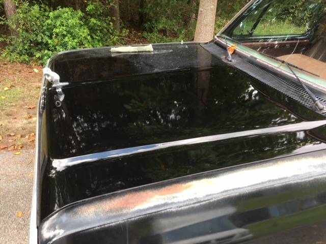

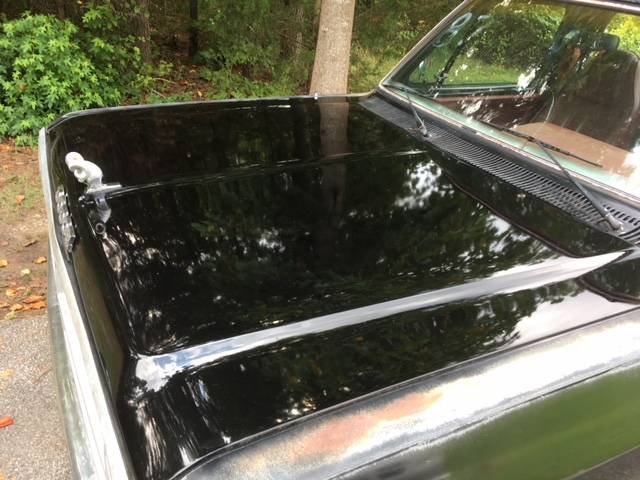

I was so excited about how well it was running that I decided to spend some time on her today. Last year when I buffed out the paint the hood just didn’t come out that good. So I popped the Dodge name off the hood. Cleaned that up with lacquer thinner. Then I color sanded the entire hood with 3000 grit wet paper. Then 3 stage buff. The hood shines mighty fine now. I may color sand the whole truck now.
