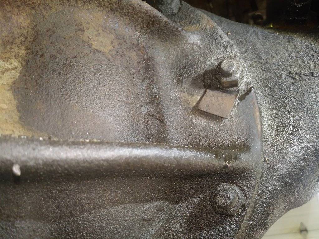

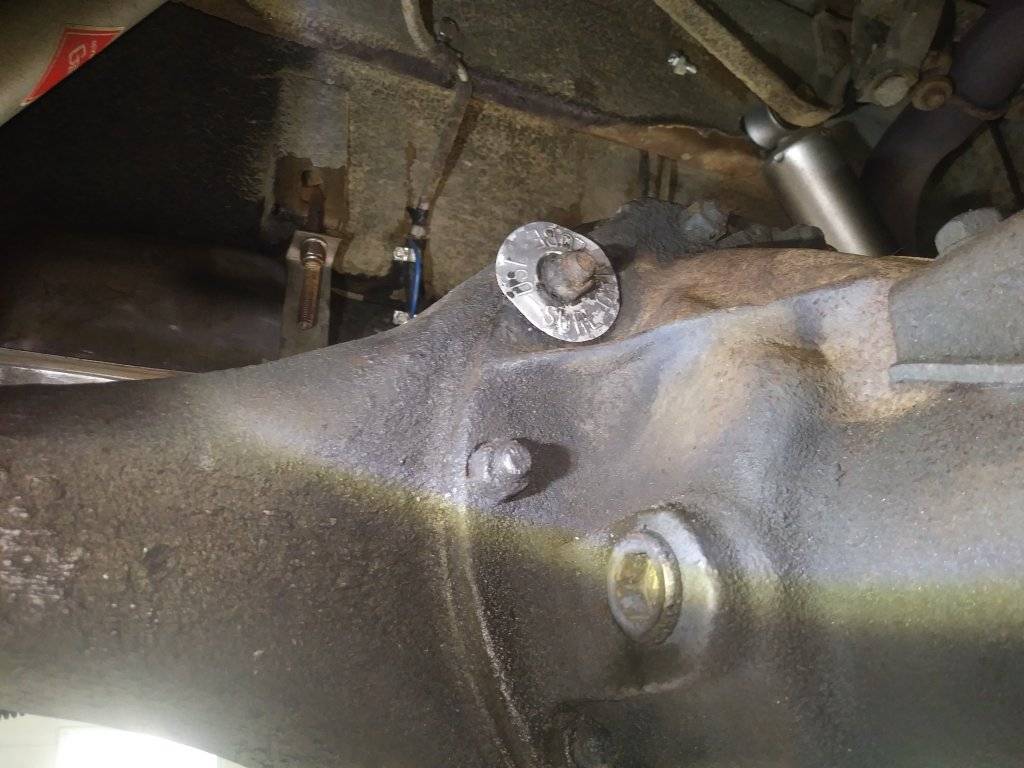

Took Grace for a spin down the back country roads..
Yep..Sure Grip works! 2 tire marks!
Tags are there and although barely legible it is a 3.23 Sure Grip!

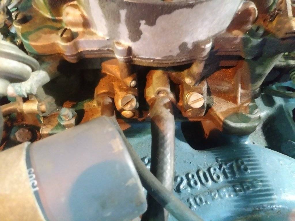

The gumbers natching AFB was running rich.
Screws were almost all the way in.
Vacuum is at 18 inches after adjustments.
Throttle is crisp no flat spots and no bog.
BOOHHHAAWW!
Grace got snap!
Still room for improvement as I had not checked the timing or read the plugs yet.

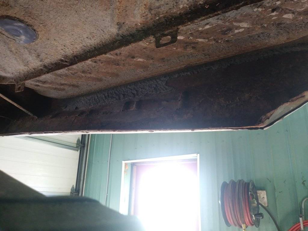

Pics of the lower quarters.
Older repairs that are holding up nicely.
This car was well loved and cared for.

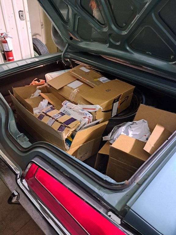

Spring is here!
During the winter months, I have been busy gathering parts and literature for this gem of a Monaco.

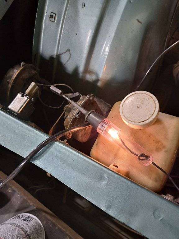

Also delved into one of the electrical issues that the previous owner disclosed.
Horn no honky..
New relay...it honks...and does NOT shut off!
Using my test light I moved the tilt/tele up and down and the test light went on/off.
So the horn button wire is getting contact in the column.
The wiring going up the column has been hacked, butt connectors at the base.
I need a turn signal switch since the left brake lights not working and left signal cancel cam is broken.

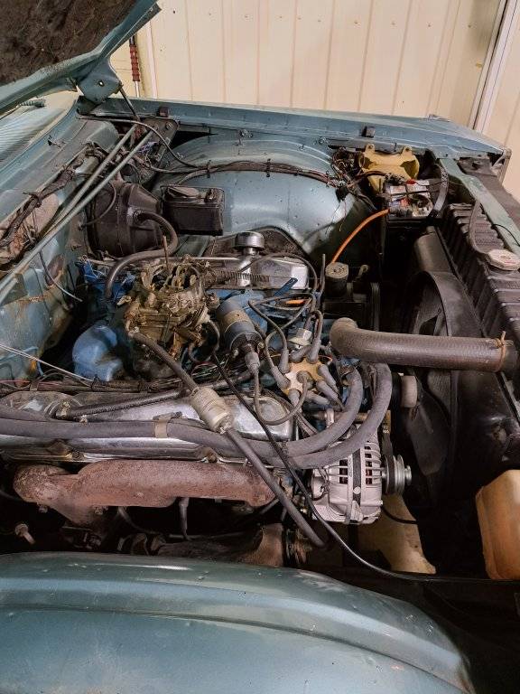

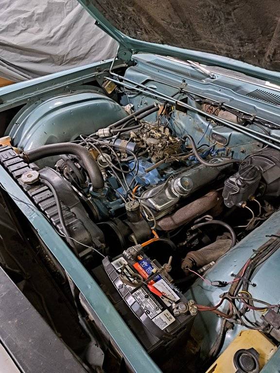

Here is a couple "before" pics of the engine bay.
The big 440 runs very well but looks worse than my daily driver.
I have the correct steel fuel lines and date coded fuel filter as the rubber ones going over the valve cover I do not trust.
Carb was rebuilt and works well.
It just needs a cosmetic cleaning.
I am getting 18 inches of vacuum at 800 Rpm.
I have the correct HP spark plug wires, washer jug, pump,and hoses.
New battery cables and hold down going on and some underhood decals.
I will be getting Evan's Engine wire harness eventually. I see too many hacked wires for my liking.
Getting the correct turquiose engine paint on its way too.
