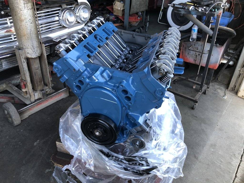

A little look at the rebuilt 440 for the 68. It was rebuilt in February of 2021. Today was the first time I’ve seen it ever since then! I had it saran wrapped and draped with an XL garbage bag and then double tarped ever since!!

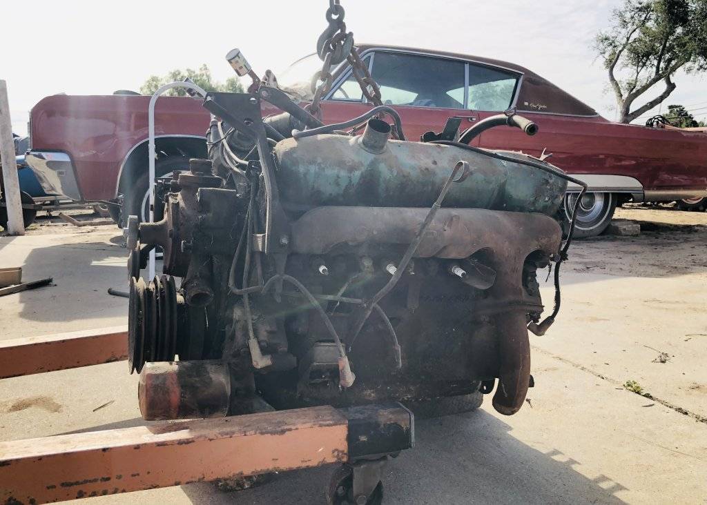

Here’s a look at it before
Check out that beautiful ride!

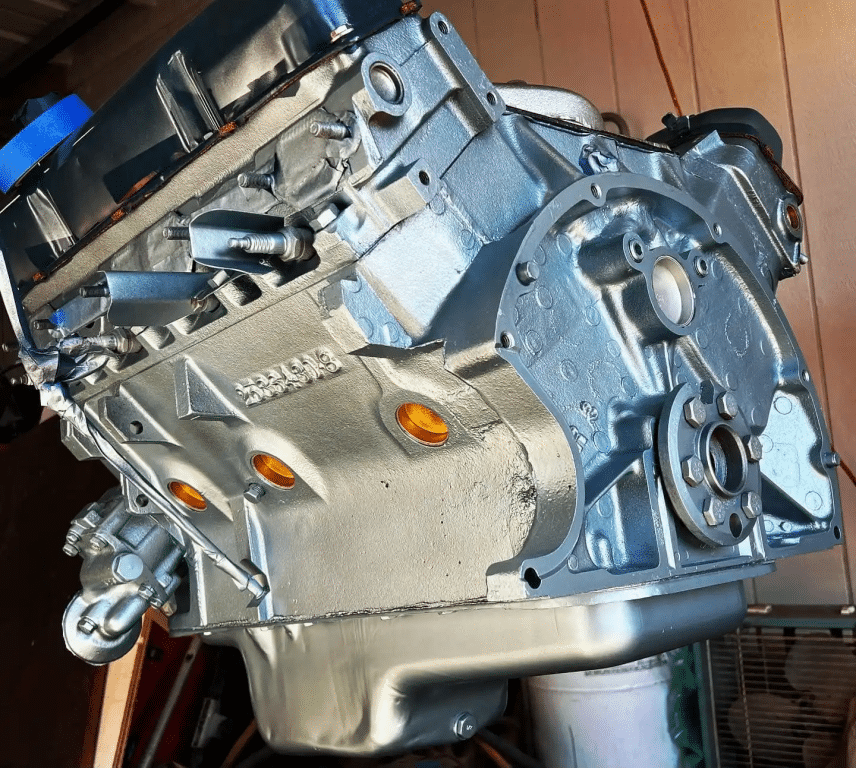

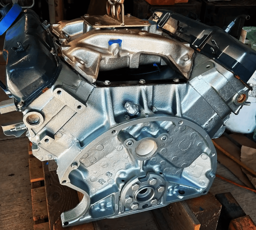

Here’s the torque monster 440 in the flesh! Been masking off the important stuff (still have more to go) so we can paint it. It’s going to be a pretty sight once it’s all dressed up and sitting back in the car!!

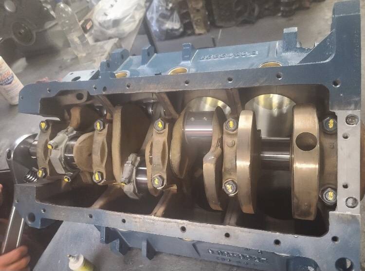

Here are some more photos during assembly

Here it is after laying down it's new color! I really love it, and I think it will look AWESOME once I put those polished finned valve covers on along with the matching air cleaner. Stay tuned. I need to figure out how everything goes back on now lol...

Thank you! It cost me $3,500 total. It's been rebuilt closely to stock as possible. Bored .30 over, new valves and springs, stock spec cam and balanced and polished the crank shaft. Heads are non ported but now have hardened valve seats! Didn't really have an interest in messing anything up as far as the engineering of this motor and how it was designed to run:) Still haven't heard it run yet but I'm hoping that happens very soon.

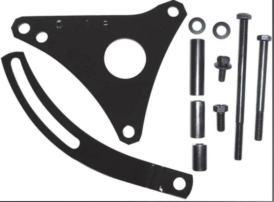

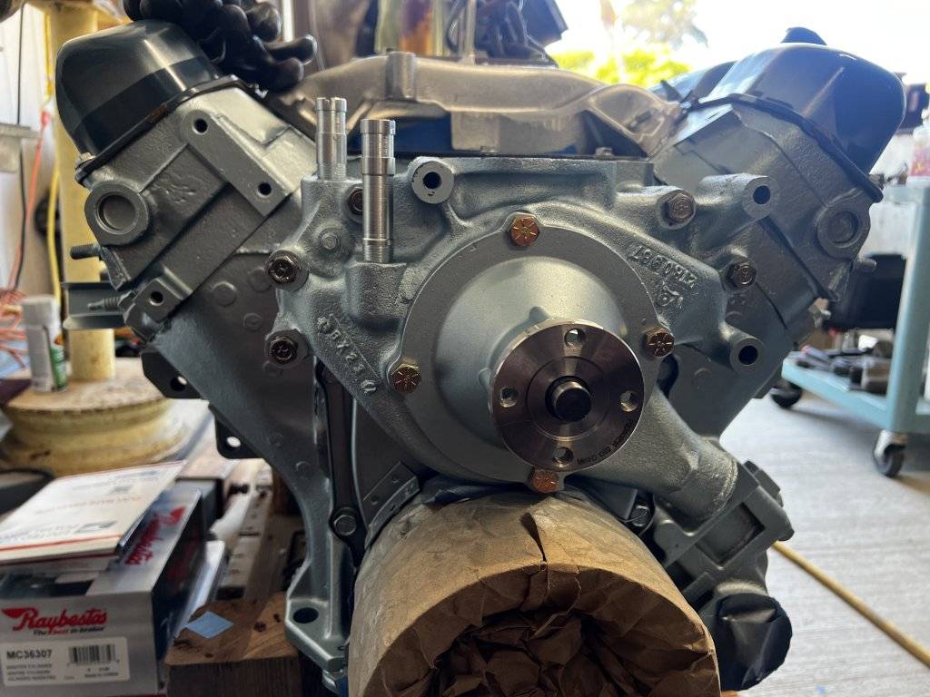

Began to mock up the water pump housing, water pump and steering bracket! Waiting to get a new alternator bracket in…
I think the black brackets will be a nice clean look / contrast against the metallic blue engine color. Can’t wait to put everything in its place for real!!
I’m going to try and adapt a non ac alternator bracket setup (not going to be running the original AC, will retrofit in the future.)
Got this set for cheap, should be coming tomorrow or Wednesday.

Off eBay? (The brackets). I looked at ones on there as my alternator bracket was sheered in two somehow. I just welded it when I priced out the brackets locally.
I should have painted them when I had them off but I wanted to throw it back together the same day and drive it.
That’s a beautiful colour by the way. It would make a nice body colour.
I noticed you’re missing the block heater. :)

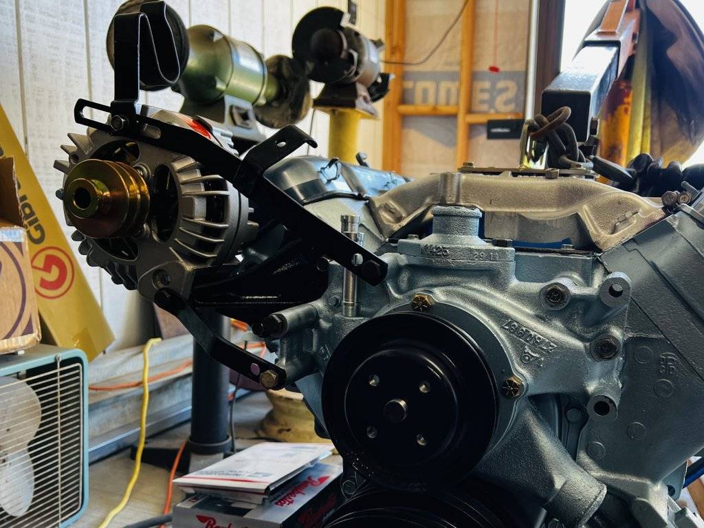

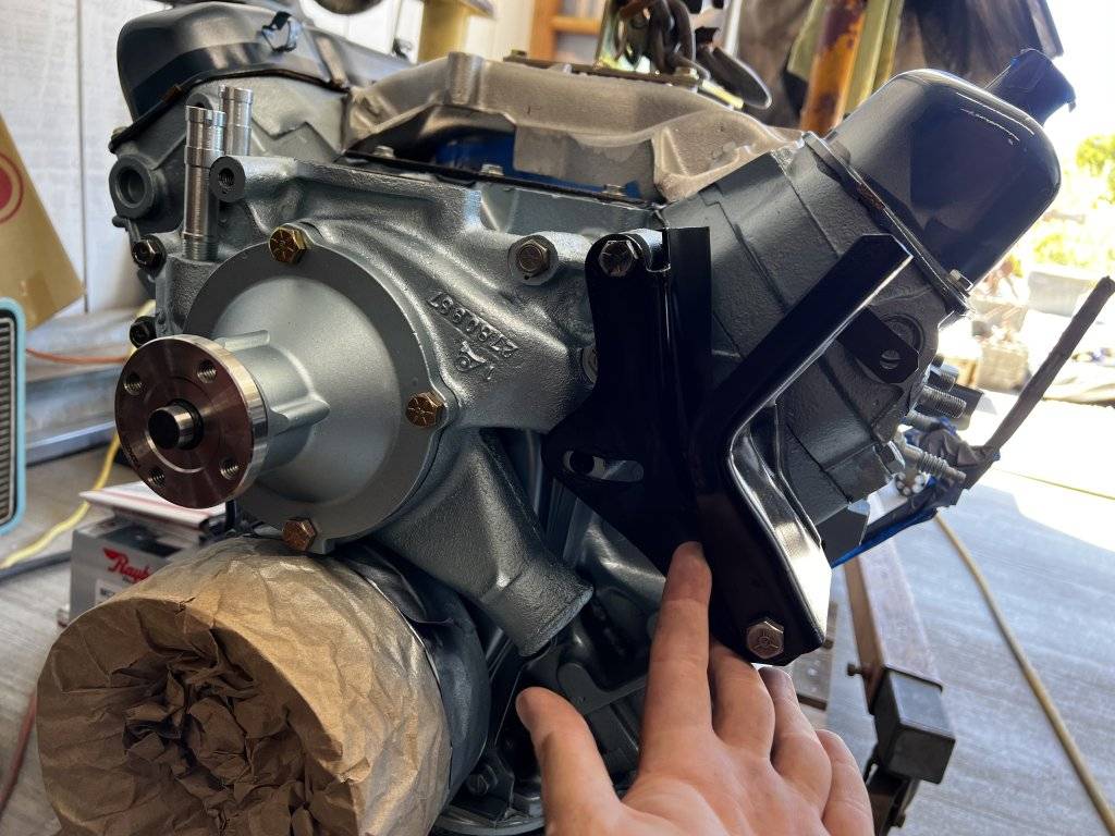

This is looking great Isaiah. I ditched the AC when I had my 440 rebuilt a few years ago. I learned through that process that it wasn’t just the brackets that needed replacing, but a lot of the pulley alignments were off when switch to nonAC equipment. I wish I had more details for you, but mine was all done at a shop. I just remember getting calls like every other day informing me of more parts I needed to by. Just putting this here in case you run into the same issue.
I ordered mine from Classic Industries! They just came in today. Also thanks btw on the color! Believe it or not it’s Pontiac Metallic Blue, they had their motors this color during the late ‘60s. I saw it once and fell in love with it. Since I’m not restoring the car back to factory I figured I might as well just paint it how i want. It’s never leaving me anyways!!
Thank you!! I am quickly finding all this out as I begin to put everything back together. Definitely (well, most likely at the moment) going to be switching to a 2 groove crank pulley.

Got the factory alternator bracket mocked up today to verify belt alignment. A DEFINITE no in terms of running this bracket without the AC. I can see why I need to use a non-ac version as well as probably having to switch to a 2 groove crank pulley.
But OOOOH doesn’t it just look PRETTY! Smiling ear to ear as I write this, I’ve waited what feels like an eternity to get to this stage.
