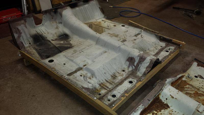

I found out that the Canadian Polara/Monaco has the Fury Floor pans and rear frame rails from this adventure with Mark's help cross referencing part #s
This floor pan is from a 65 4dr and it is the perfect match for my convertible!
The part # for this forward section fits all the Fury's and Polara/Monaco model and we guessed the US model Polara's have a longer rear pan extension simply from different part #'s listed
Mine is the perfect length already

Yes that is the best way to remove the rusted floor but when removing a good floor to put back in another car you don't have any choice but to remove every spot weld.
This is what Mark was able to do on the donor floor pan. He did a great job supporting the pan with 2"x3" and 2"x4"'s to keep the twist action to near zero.
