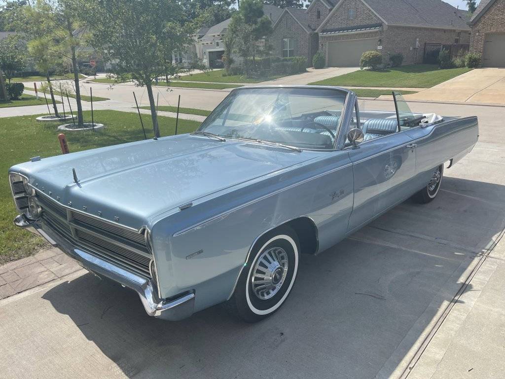

howdy, i have restored my first car. it was given to me by my grandparents when i was 16. i have had it ever since. i restored it a year ago. i am not a real car guy so please forgive my naivete. i spent much more restoring this thing than it is worth - but it has sentimental value. here is my question...
where on earth can i find that AC compressor? i have looked everywhere. the images that pop up are NOT what you see in this picture. so, i thought i would ask if anyone knew of a place/person i could speak with. thank you.
