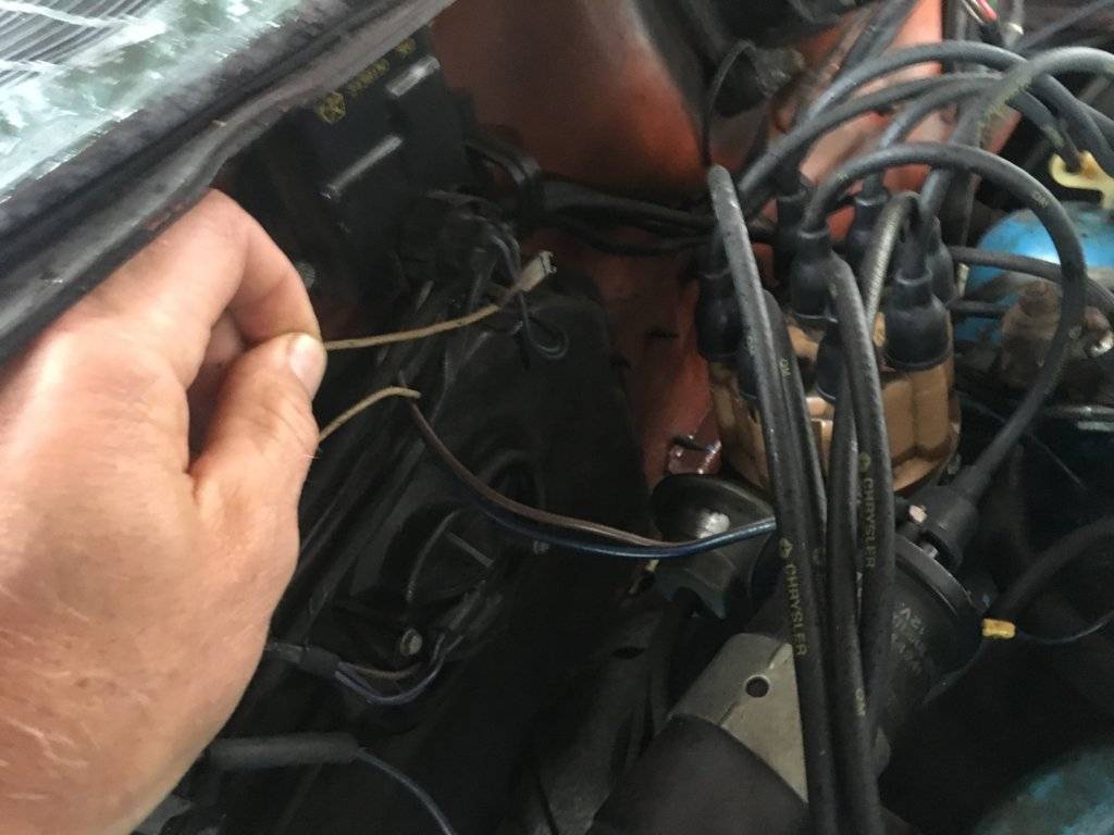

1970 Plymouth Fury 3 with 318ci, anyone know where this wire suppose to live?
You too uh? I got the same color wire loose on my 69 A100, with /6 so go fig? Good Luck
I agree, Oil Sender wire. Ground it, if you have a warning light, it will illuminate. If you have a gauge, it will peg high.
I have a gauge and it works fine now. Are you saying if I ground it, I'll peg the gauge?
Some California emission packages had a wire hooked to the vac advance on the distributor. If yours was not a Ca. package the wire does not hook to anything or do anything..
Dave
If you have a factory gauge, that wire has nothing to do with the gauge if yours currently works. Do not ground out the wire as it could be a hot lead for some accessory that your car does not have.

Your wire could be anything.... A disconnected gray wire at the back of a 318 in a '70 Fury is a pretty easy deduction. A slant six A-100 with a random gray wire in an unknown location... not so much.
I'd look in the FSM and see what wires are that color and go from there.
