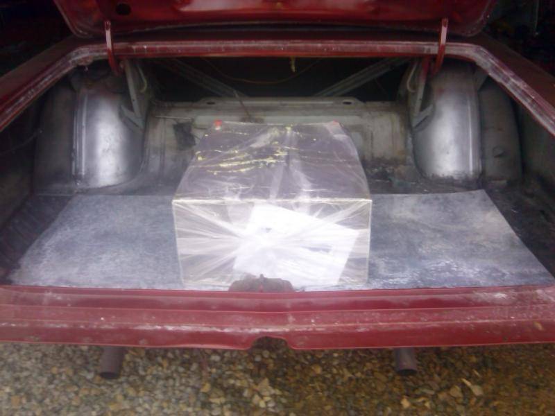

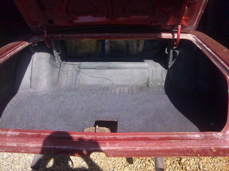

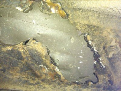

Thought I'd update with a little progress... To start my trunk floor had a previous patch job involving some tin sheets, roofing tar and rivets. I peeled all of that up, altho some stubborn tar remained. I took a cut off tool and cut the worst of the rust out. I then used long haired fiberglass and filled the holes. Then I cut a sheet of galvanized sheet metal to lay over top of everything and kind of clean up the look. I used two tubes of liquid nails to attach the sheet... Now I can cuss myself next time ha ha! Bought a couple cans of trunk spatter paint to make things look presentable. Not a perfect job I'll admit. But the rust has been treated and it is now strong. You do your best when you don't have a welder or the money to buy a new trunk floor...

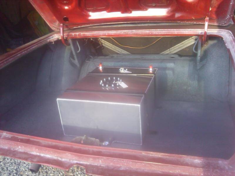

I should have the fuel cell mounted and plumbed this week. No more jug of antifreeze for a gas tank! Its progress...

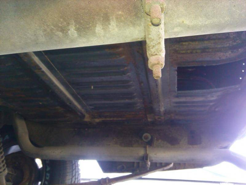

looks pretty good. nice job. any pics from underneath would be cool. just so we know its not all cosmetic. lol
Ha ha! I'll take some Wednesday when I get back over to work on it. I won't lie there were some fist sized holes that got filled! I will be doing some more cleaning on the underside and under coating as well. But I'll get y'all some pics of my "Appalachian Engineering"!
