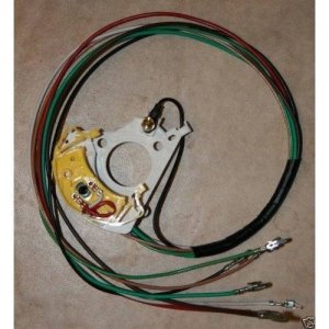

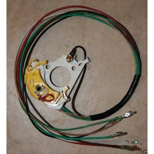

Thanks. Have you ever changed the combination switch for the turn signals/brake lights (in the steering column)? I was told that I need that part, but can't find it online.
The issue is apparently no contact for the driver side bulbs while braking, but the left signal works (same filament). Also, my front passenger blinker only comes on if I lightly push down on the lever after pushing it up to the right signal position.
I want to know how to name this switch so I can find one, and how much of a pain it is to change. IE: should I leave steering column junk to the pros?
Try this but read full description to make sure you get the right one.
https://touch.ebay.com/tablet/item?itemId=310612668729&sk=SCH_643621
Can you do it yourself? If you have the service manual for the car I would say most definitely. if you have any issues while you're at it you can always log in and somebody who may or may not be who they have pictured in there avatar should be around to advise.

Congrats, you now have a link to seach Ebay... I think Matt missed the link that he intended...
"Turn signal switch" is the proper terminology, as is steering column.

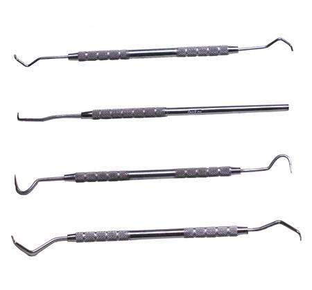

Not sure how mechanically inclined you are, but it is not difficult, provided you have a steering wheel puller, or a universal puller, and a straight pick to depress the tabs to remove the individual wires from the mass plug. (pictured in post)
I can give you a vague outline, and you can decide if you want to do it yourself, or take it to a shop with a decent history of not hosing their customers. Shop time should be 30 to 45 minutes to do this...
Your best reference to get parts for your VIP will be a Fury III. I don't think that the Plymouth C-bodies had cornering lights, but in case someone switched the steering column, you need to look in beside your turn signal lever on the column... if you see white, you have a standard switch, and if you see red it has a switch for cornering lights.
I'll wager on white, so now you can find your (complete) turn signal switch. I would really try hard to find one that is made anywhere but China. Dorman may be a possibility... Standard generally has a USA made box with Chinese parts inside... Through Sturdevants I got a connection to a place in Colorado that makes them...
Here's a link to a very likely Chinese part for a reference... and maybe last resort..
http://www.amazon.com/Signal-Switch-1967-1969-Plymouth-Monaco/dp/B0088IW3L0
Once you get your switch, and a puller, you can remove any trim pieces below the column, so you can find the turn signal plug... Unlatch, and unplug, then draw a sketch of your plug to map where your different colored wires go. Now use your pick entering the backside of the plug, beside the wires to push in the retaining tangs to release each wire.
Once your wires are loose, take about a 2-3 foot piece of fine single strand wire and cinch the wires together and wrap some electrical tape over your connection....

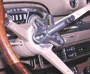

Now pull your horn button off... 1/4 turn counterclockwise... horn switch... remove 3 screws and a plug... remove steering wheel nut... 3/4"... put your puller on... I'll venture (2) 1/4", possibly 5/16" course thread bolts... pull the wheel by running in the center puller bolt.
There will be one long screw holding the lever to the switch, and (3) around the steering shaft... also save the steel ring... Now pull the switch upward and out, but stop when you come to your Frankenstein joint, leaving the single strand wire in the column.
If the new switch comes with the plug in place, twist the plug sideways, then attach the single strand wire and retape the connection, keeping it's profile as small as possible to pull it back down through the column.
Reverse procedure, pray that the new switch works, then have a victory beer.... and a cancer stick if you must...

Not a straight one in the bunch, so just picture one of them if it wasn't bent...2009-09-19_222311_picks.jpg

As far as special tools that you need for the steering column like the steering wheel puller. You can go to Advance Auto Parts or AutoZone or pretty much any of the automotive stores similar to those that have a free loaner tool program. You can go in those stores. put a deposit on the the special tool, fix your VIP, and return the tool and get your deposit back. They have a bunch of other loaner tools too so check that out too. That can save you a ton of money if you only use the tool once or twice.
