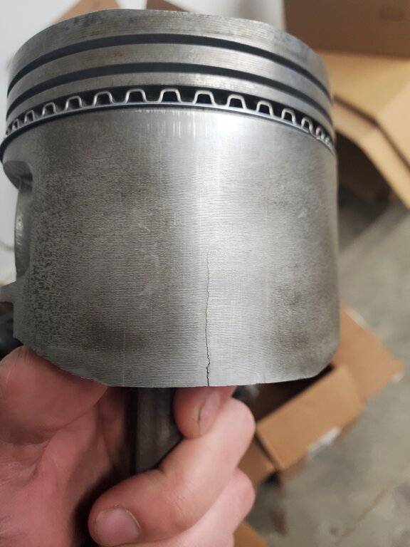

    Hey guys, so if you follow my other threads you knowni am rebuilding a 318 poly out of a 1965 Plymouth Fury. I started to put the bottom end back together and moved on to installing the piston rings once the crank and everything was back in. I was installing the oil ring on piston 5 and noticed the skirt is cracked as you can see in the pic. Looking to see if anyone has NOS and is willing to part with just one piston head. Any help would be amazing and I would be forever in your debt.

  5. Ross Wooldridge
    Ross Wooldridge Senior Member FCBO Gold Member
    Messages:
    3,390
    Likes Received:
    1050
    Joined:
    Apr 25, 2016
    Location:
    Scotland, Ontario, Canada
    Just curious - could a cracked piston like that be repaired?
  6. bluefury361
    bluefury361 Old Man with a Hat
    Messages:
    13,388
    Likes Received:
    9815
    Joined:
    Mar 9, 2011
    Location:
    Alabama Gulf Coast
    I wouldn't take a chance like that. A set of pistons isn't that expensive compaired to what would COULD happen.

  9. gyknot
    gyknot Member
    Messages:
    108
    Likes Received:
    30
    Joined:
    Nov 20, 2018
    Location:
    Deer Park, Wa.
    Frankly, if I found 2 cracked pistons, I'd probably buy a whole new set. If 2 have gone bad, how close are the other 6 to going as well.
    As for fixing them, I've never heard of it being done but that doesn't mean it hasn't been.
    • Agree Agree x 3
  10. jcslocum
    jcslocum Member
    Messages:
    88
    Likes Received:
    39
    Joined:
    Oct 5, 2019
    Location:
    Eastern Shore, MD
    Welding would probably distort it too much and require rework which would take it out of tolerance.

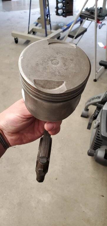

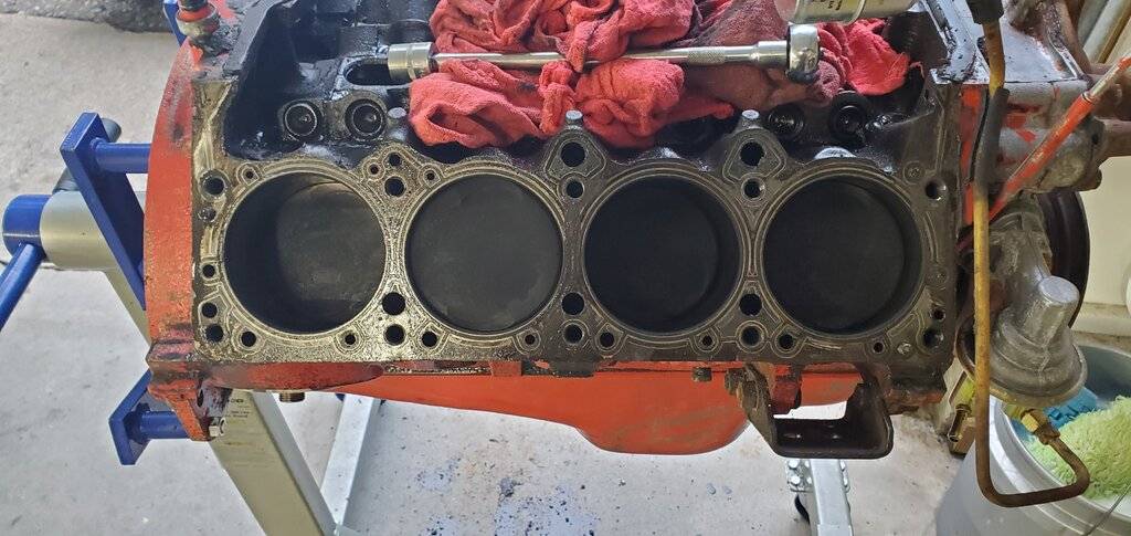

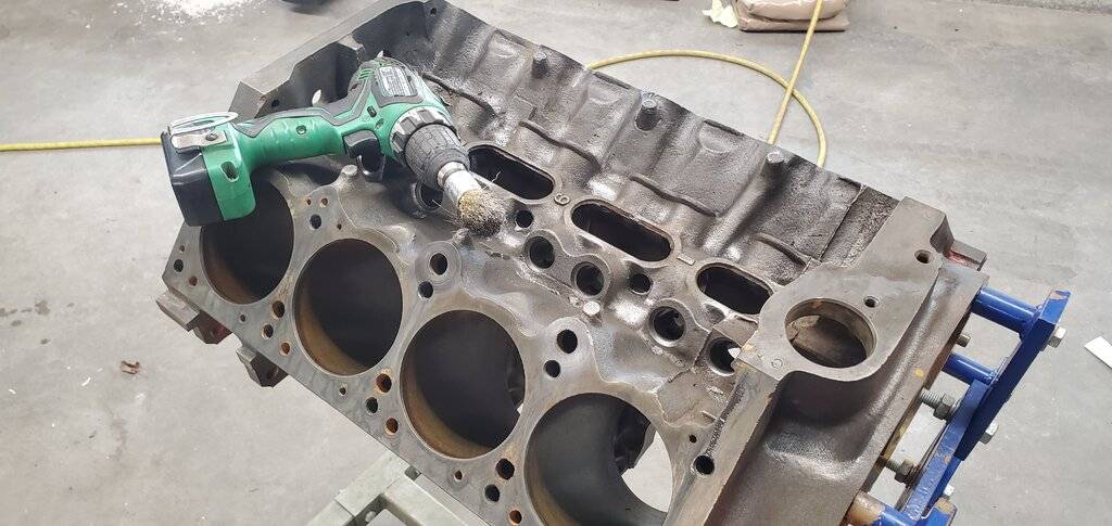

  14. Rooster34
    Rooster34 Member
    Messages:
    103
    Likes Received:
    88
    Joined:
    May 24, 2020
    Location:
    Maine

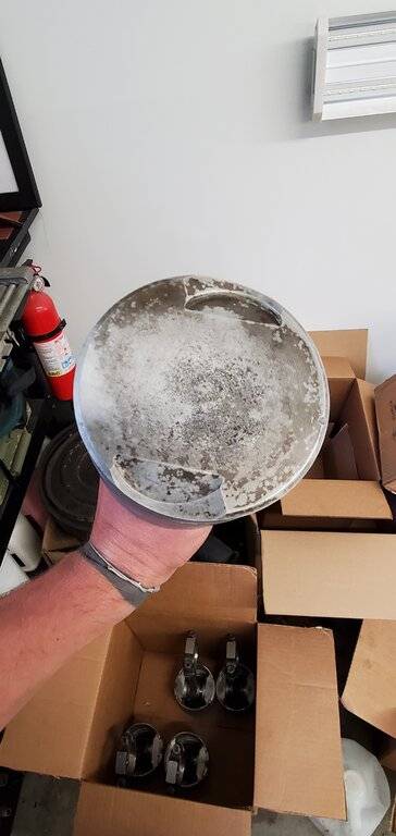

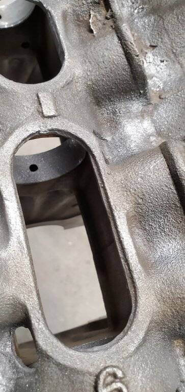

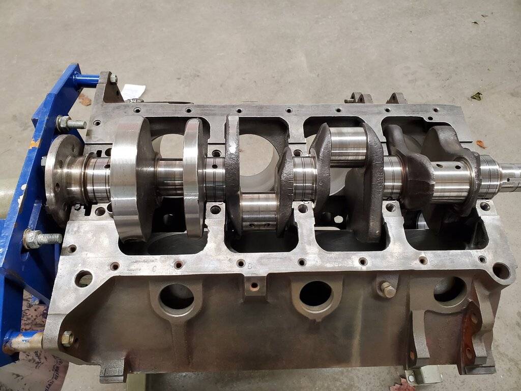

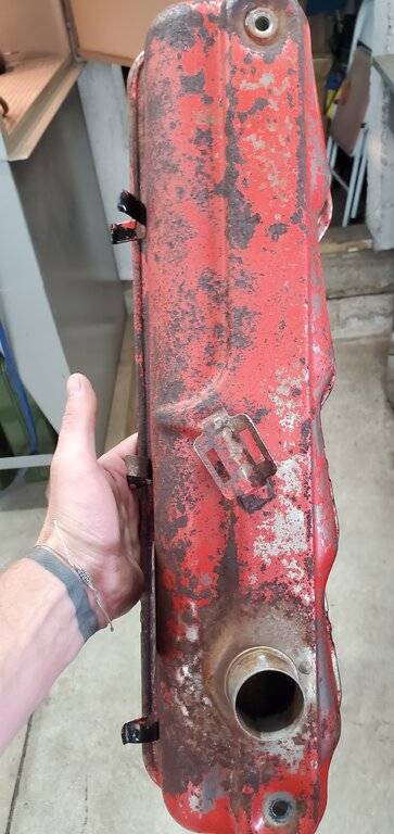

    No not using the old rings, im replacing all of those and all new bearings and gasket, pretty much doing a refresher. Ive attached photos

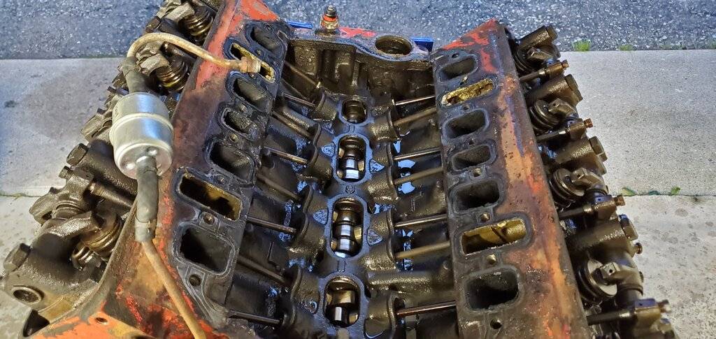

  15. Rooster34
    Rooster34 Member
    Messages:
    103
    Likes Received:
    88
    Joined:
    May 24, 2020
    Location:
    Maine
    And some more
    • Like Like x 1

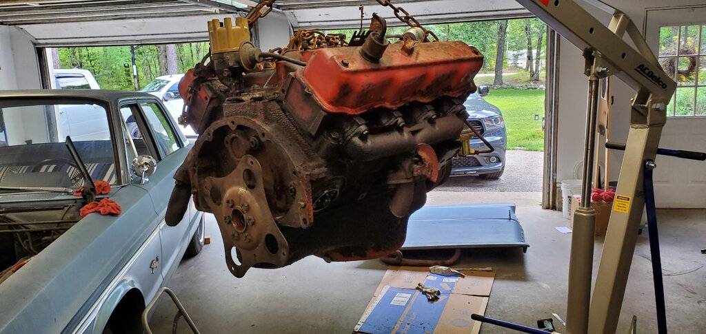

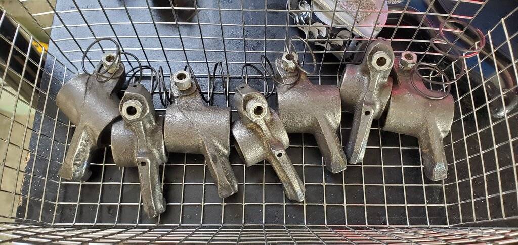

  16. Rooster34
    Rooster34 Member
    Messages:
    103
    Likes Received:
    88
    Joined:
    May 24, 2020
    Location:
    Maine
    and a couple more
    • Like Like x 2

  18. 413
    413 Well-Known Member
    Messages:
    733
    Likes Received:
    235
    Joined:
    Jan 28, 2019
    Location:
    NW USA
    What I mean is look at the top of the piston, it is not symmetrical on the valve reliefs. So there is a right and left piston. Turn it over and up inside there should be a part number inside of a factory piston.
    make sure you get the correct replacement piston, amend put them all in the correct hole so piston doesn’t hit the valves.

  20. Rooster34
    Rooster34 Member
    Messages:
    103
    Likes Received:
    88
    Joined:
    May 24, 2020
    Location:
    Maine
    It is because it is a poly head or an A series engine and has canted valves. So yes I will make sure I get the correct ones!
