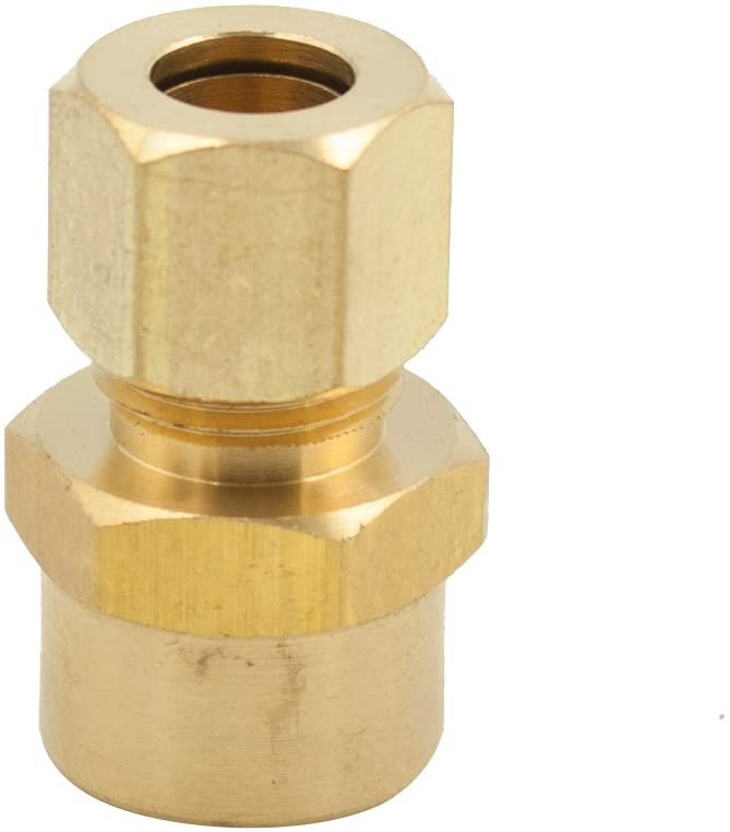

If you aren't going to do anything besides move it in the yard, and NOT out on the road, you can find a 3/16 compression fitting with a pipe thread like this...
Or this...
Then you find the matching pipe plug or cap. Cut the line so there's enough sticking out to get the compression fitting on... Or even grab a new piece of pre-made line and cut it so you can use the compression fitting.
Of course, NEVER, EVER under any other circumstance where the car is actually going to be driven, should you use a compression fitting on a brake line. This is a TEMPORARY fix.
