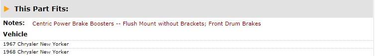

1965-1968 Chrysler New Yorker Brake Booster - Centric 160.80025 - - PartsGeek.com
but don’t know if they’d work! Here’s what I’ve been contemplating,
NOPE, web page clearly states 'Drum Brakes".

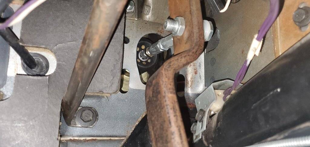

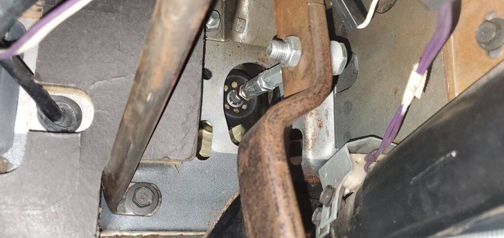

It would help if you would post up pictures of what equipment you have on your car as many parts could have been changed over the years.
I'll just rub the crystal ball and cue up some swami music and take a guess that you have the BUDD brake 4 piston caliper system with a specific master cylinder and booster. Or has someone converted the car to disc brakes over the years?

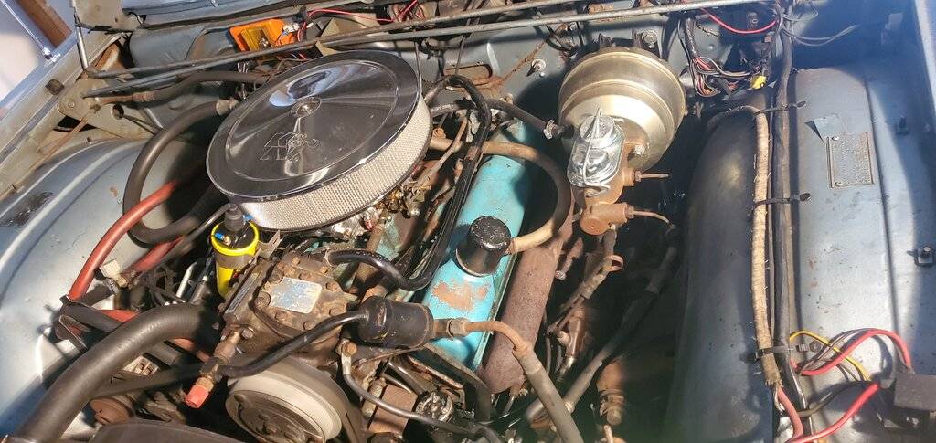

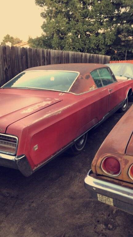

It’s all bone stock as far as I’m concerned. Car was abandoned in 1980 at Tom Merkel’s Cuyama Car Garden... you’ll find a lot of info on that place on Google Heres the best pic I have. Car isn’t at my house as I live in a suburban area of So Cal where there’s not much room to have the car at home to work on so it’s at my buddies house about 20 mins away... he’s got an acre plot!!

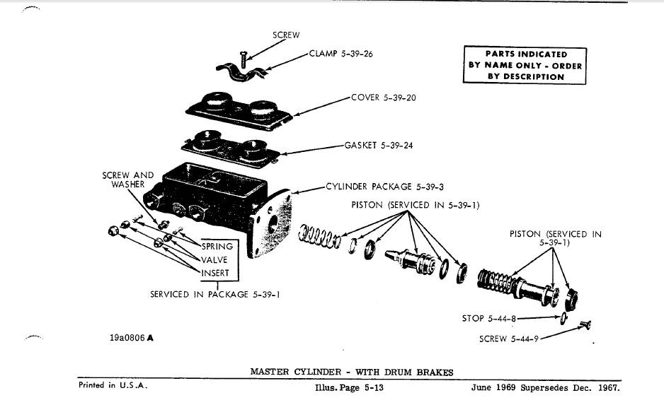

Are you sure that it has disc brakes up front? that is a drum/drum master cylinder.

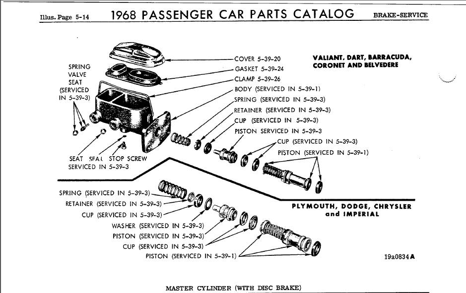

Well from the Chrysler Parts Manual it looks like you have a drum brake master cylinder (or who knows what that could be 'aftermarket' over the years).
Drum vs Disc Master cylinders.
Three types of disc brakes for 1968, Kelsey Hayes, Bendix, & Budd. The Kelsey Hayes & Bendix were used on the smaller body cars and the Budd on the full size 'C' Bodies IIRC. We need to see a good picture of your calipers.
Master Cylinder I'm not too sure of via the (exploded) parts manual and service manual pics. I could check my archives of pictures but I'm pretty sure that if they are Budd brakes that it has a very large brake booster that looks different than what you have.

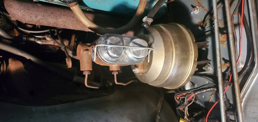

I really appreciate your help:) So, given that I do have a drum brake setup - could this work? 1965-1968 Chrysler New Yorker Brake Booster - A1 Cardone 54-73520 - - PartsGeek.com
Cardon't boosters are mostly junk. They are also famous for shipping the wrong booster and in the meantime your core will get rebuilt and sold to someone else and you are stuck with a booster that does not fit or does not work. Booster Dewey does quality work and stands behind what they do. Be sure to replace the master cylinder as the main reason the booster units fail is because the master cylinder leaks brake fluid into the booster and degrades the insides. All hoses and wheel cylinders should also be replaced at the same time unless they are of recent install. If possible, avoid the China Crap cylinders sold at Auto Bone and Car Crap as there are lots of quality control problems with them..Mobileparts, a vendor on this site, has quality US made replacement parts. The booster in the photo is a Bendix single diaphragm booster and it is probably a correct after market replacement. Most '65-'68 Chryslers had a Midland-Ross single clamp booster as factory equipment, but either booster is a good unit.
Dave
you won't know if the booster is bad until the car is running. you may want to wait , it could be ok ,then you could put the money elsewhere.
If your car has been sitting for 40 years replace all the rubber components. Craig @ mobileparts is a member here and he knows and has what you need. Booster Dewey is where you need to send your booster. These guys are good people who will do you right.
