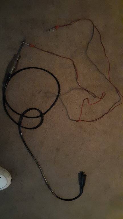

Lets see if I can help you. Check your bulkhead connector for poor terminal connection, corrosion build up at the terminals. Were your ignition parts US made. There are a lot of China crap made parts out there. They have huge reliability issues. Second you will need a test light, a roll of duct tape, a 16 ga. jumper wire 3 ft. long w/ alligator clips on each end. Tape the test light to your windshield. Secure the test light ground wire and clip the jumper wire to the test light as in the photo below. Route the jumper wire pass the engine cowl and attach the alligator clip to the ignition side of the ballast resistor. This set up will allow you to monitor whether there is a loss of power to the ignition coil the ignition switch or in the wiring harness to the ballast resistor when it dies. If the test light remains on the ignition switch and the associated wiring. PM me if still need help.

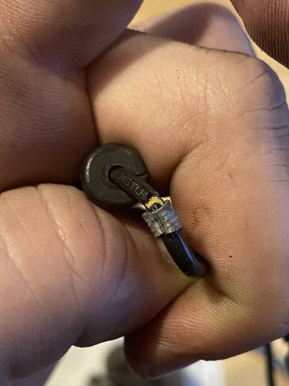

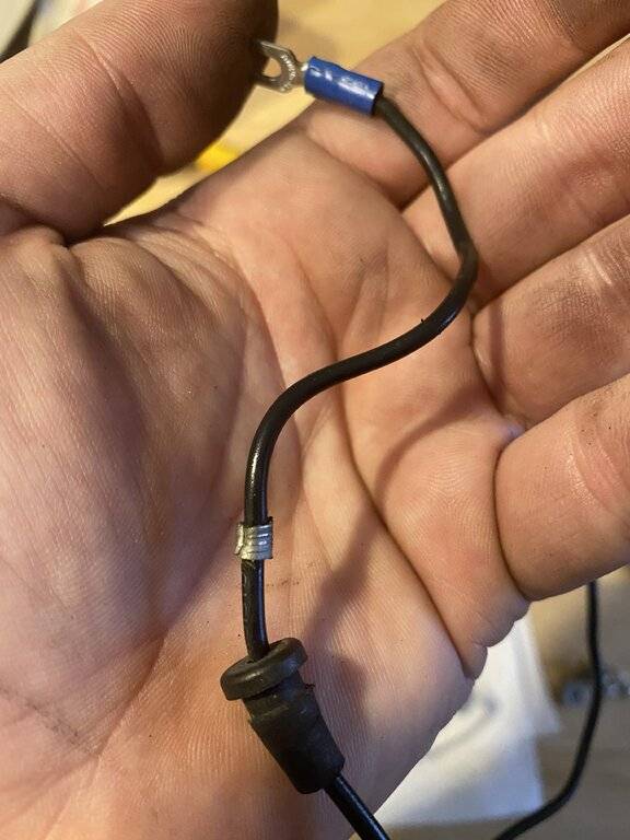

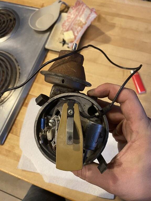

I didn’t have much time today to try any of those tricks (working outside in the winter isn’t fun). But I did pull the dizzy and found this crack in the wire with this little metal piece.

Being put onto daily grinder duty, and the distributor already out.....
Now is the time to install a Pertronix electronic conversion kit in the distributor.
Worth the expense now and less headaches later.
CBODY67
Mar 27, 2011
7,935
5,034
Looks line somebody re-terminated those wire ends and didn't bother to put a drop of solder on the bare wire ends and the new terminal, for good measure.
Would be a good time, as mentioned, for that internal electronic upgrade kit, if desired.
