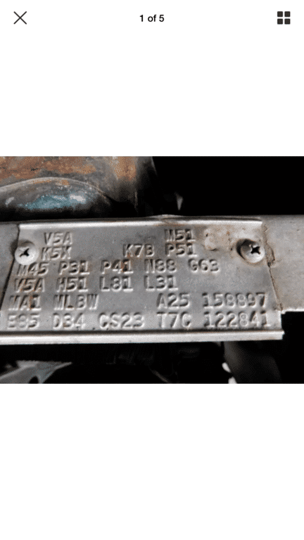

Ok guys! I’m hot on the trail of a 77 sunroof New Yorker. Not THE Turbine Bronze Sunroof New Yorker, yet... but! One I am seriously interested in. I need help deciphering the Vin tag pictured please..
Owner states that this was a special order car. And by the looking at the pictures he sent of the car, it either has to be or somebody is colorblind. LOL.. I’ll add pictures of the car later once I have some more details. But at the moment if you guys could decipher the Vin tag for me, I’d really appreciate it. Thanks

Here are the ones I have:
A25 interior convenience group
D34 Torqueflite transmission
E85 engine? (was used for 440 engine, but was not readily available for '77)
G33 LH outside remote mirror
H51 Single A/C with heater
K5X
K7C
L31 Fender mount turnsignal indicator
L81 Door ajar monitor
M45 Fender skirts
M51 Power Sun Roof
P31 Power Windows
P41 Power Door Locks
V5A Vinyl side moldings, color unknown
Vin Number CS23T7C122841(Chrysler, Special, 2dr price class 3, 440?, 1977, Jefferson assembly plant, sequence number 122841.
Order Number 158897
The remaining codes MA1, MLBW Are probably upper and lower body colors of unknown color. I believe the two K codes are for the interior and vinyl top.

Not many of the codes translate well from the earlier years:
CS23:
Chrysler
Special
2 Door Hardtop
T7C: 440 1977
Jefferson Avenue, MI, USA
122841: Sequence number
E85: 440 cid 4 barrel V8 350hp
D34: Light Duty Automatic Transmission
MA1: Exterior Color
MLBW: Trim - Opt. Decor Group, Unknown, White/Blue
: Int. Door Frames
A25: Build Date: October 25
158997: Order number
V5A: Top Color
H51: Air Conditioning with Heater
L81: Unknown
L31: Hood/Fender Mounted Turn Signals
M45: Unknown
P31: Power Windows
P41: Power Door Locks
N88: Auto Speed Control
G63: Unknown
K5X: Unknown
KB7: Unknown
P51: Unknown
V5A: Body Side Stripes, Gunmetal Gray
M51: Power Sunroof w/Vinyl Roof
From what I've seen over the years if was truly a "Special Order" there would be another tag on the rad support.
My '79 300's vin begins with "SS" so it must be Super Special!
I believe that the second letter in most of our vin numbers indicates trim or pricing level. My '67 LeBaron for example is YH. The "H" meaning High.

The only reason for a two-part data plate would have been that one was not big enough to hold all of the needed option codes. The VIN designations were RWXS, Coronet/Small Fury/Charger SE/Cordoba, respectively. "S" would have been "specialty" for the Cordoba 300, as I recall, as the Cordoba with the 300 edition would have been "Cordoba Specialty". The New Yorkers I saw at the dealership, circa 1874-76, where they had the window sticker with individual items of the various option packages, where available as such, listed separately would have generated a two-part data plate, too. Whereas if they'd ordered the option packages instead, probably not.
In the case of some earlier specialty cars, as a Challenger T/A, there was an additional data plate by the main one, noting the "T/A" status. A friend had one, back then, when it was a "used car", before anybody really cared about them.
