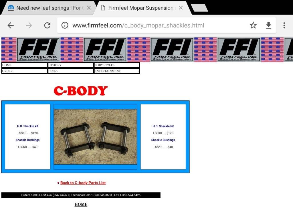

Try www.firmfeel.com they have everything you will need. Even the offset shackles.

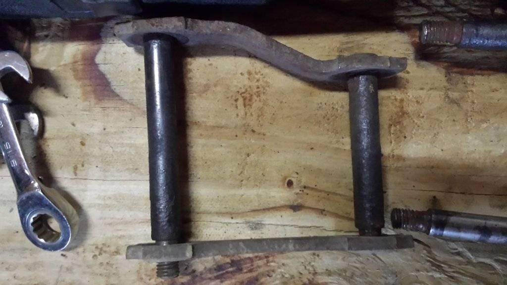

Springs and Things were working on making the offset shackle . They had asked me for one when I pointed out to them that these thing existed, apparently they never knew it.
I've never seen a reproduction offers shackle
We've discussed offset shackles ad nauseam here.
This type of offset shackle, which I think may be used in some early 60's C-bodies, may be duplicated with a mini van shackle. I've never had reason to investigate as I don't own one of those cars, so don't take my word for it.
Easier to start ah thread then to find the one I'm lookin' for
proxy.php?image=http%3A%2F%2Fi.ebayimg.com%2Fimages%2Fg%2F4c8AAOxygLxSUu-8%2Fs-l1600.jpg
The shackle needed for a fuselage car has one straight and one bent side.
NONE of the offset shackle packages for race cars or mini vans will work. NONE of the suppliers that list a shackle for a fuselage car has the correct shackle.
