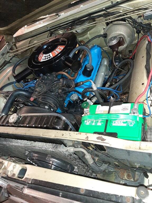

Reluctantly, I recently put a 4 barrel Holley on top of my 68 Fury III’s 383. The throat has a 5 3/8” opening. I really don’t like aftermarket air cleaners so I’ve been thinking...Would there be a period correct factory air cleaner that would properly fit on top? If so, I’d like to find/buy one on eBay. Thanks...

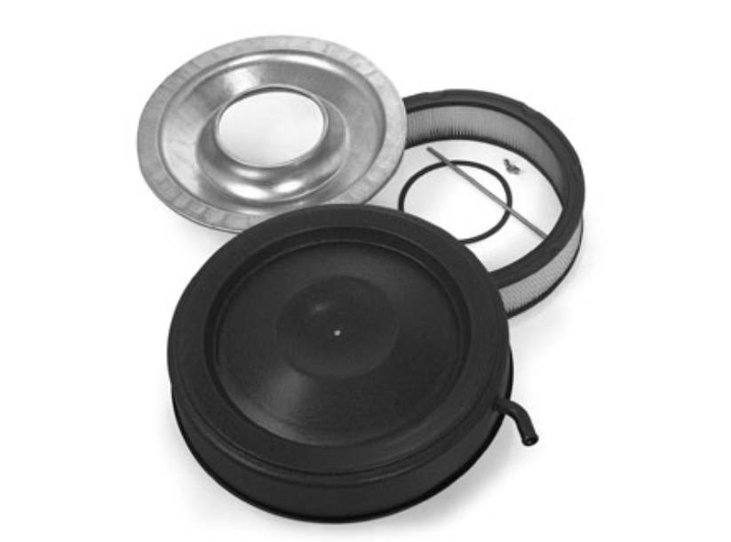

The period correct air cleaner is a dual snorkel with the oval snorkels. See: www.nicksgarage.com/aircleaner.htm
Dave

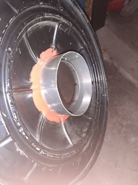

Keep in mind if you have your OEM air cleaner and it won’t fit the carb top because of the base’s hole size. Buy any ol’ base that fits your carb and use your OEM top. You may have to experiment with filters to get the right fit. It’ll work like a 69 low restriction set up. You’ll have a gap all around the base but with the right filter nobody except the nosiest of gawkers will see the mod.
The carbs were pretty much standardized at 5 1/8" for the factory AVS and Holley 4160 that were stock equipment. A period correct air cleaner will not fit a carb with the 5 3/8" throat. Goose is correct, you will need to find an after market base and try to adapt it..
Dave
Dave...thanks for posting photos. Basically, that dual snorkel looks like my stock air cleaner (top) with an extra snorkel. Hmmmm. I see the originals on eBay. Throat opening may be standard but what about other clearances? Have you or anyone else ever correctly fit a late 60’s dual snorkel air cleaner on a new aftermarket Holley 4 barrel?
Goose, thanks for that tip...that’s precisely what my friend said to do and that’s what I have now: Smaller aftermarket base that has correct throat opening. Has a gap all away around the bottom that is not noticeable but I have it in my mind what the original looks like/fits like, so thats what I want, if possible. I may have to settle with this clever option though.
thanks...
Thanks Dave, I understand...you posted answer before I even asked. I appreciate it, thank you. I don’t want to spent 300+ on an original dual snorkel air cleaner and find out it doesn’t fit.

Sounds like you’ve got it right already! I like the smaller base with room all around for the air to enter.
